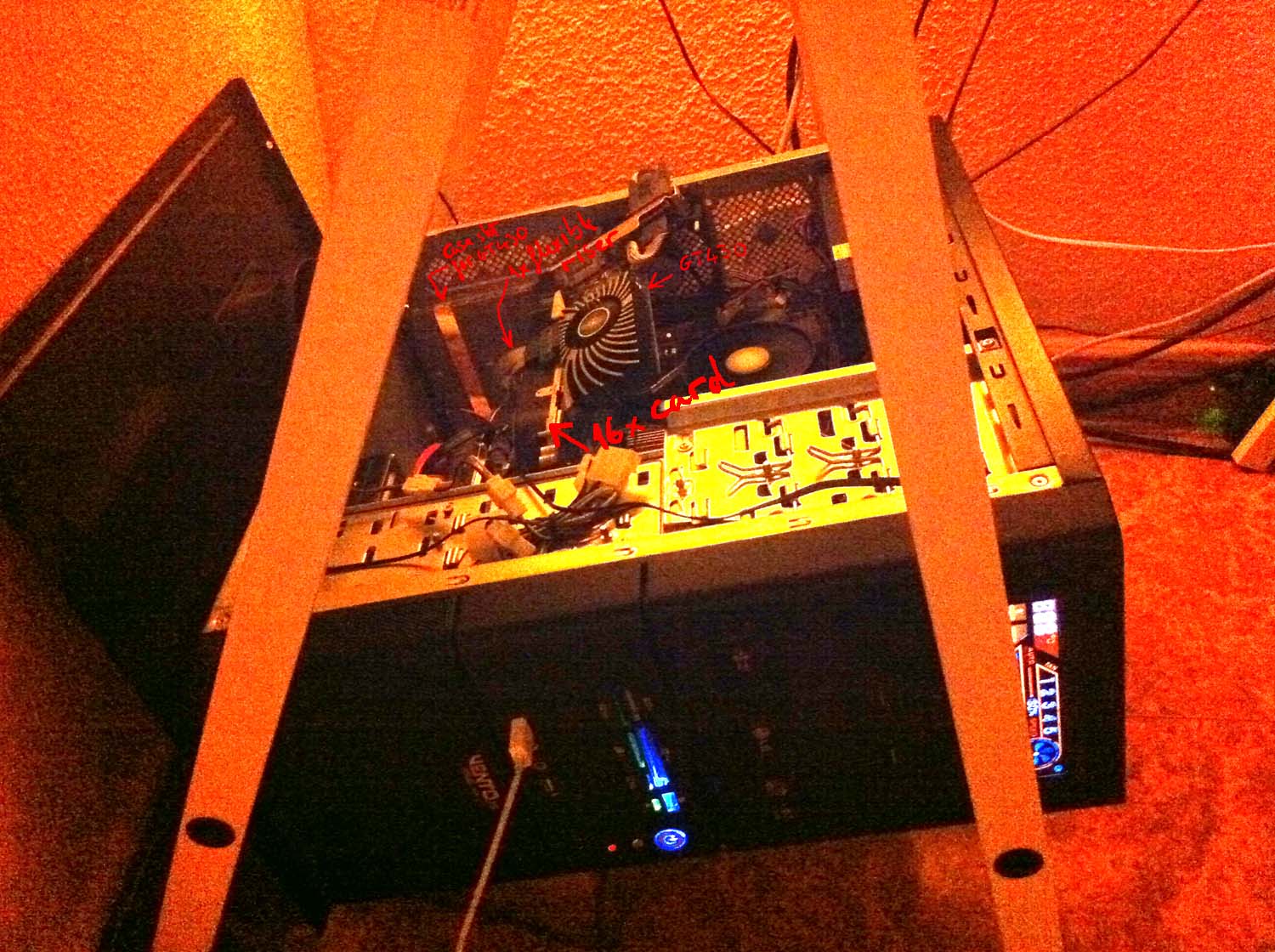

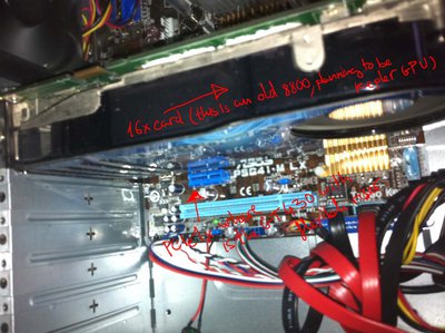

Here you have two pictures of my system.
I use a GT 430 in the 1x PCIe for octane and a GTS8800 with two monitor in the 16x
I plan to substitute the 8800 with a stronger nvidia GPU (either upcoming kepler or 560 Ti, deppending on when finally arrives kepler).
Then I could have 1 or 2 monitor to 16xGPU and 1 monitor to 1xGPU.
I would use 16x as regular gpu and, when i want to use octane, put the octane interface in the 1xGPU monitor (and deactivate the other monitors) and use the 16xGPU for processing with octane.
By now I'm using the 1xGPU for octane, because it is fermi, better than the 8800, and it is really good when I let octane processing in background and still use the computer.
I used an eBay 1x pcie riser for 4-5€
The card GT430 is LOW PROFILE (ASUS model). That was a luck, because the riser make it wider, and if you want to be able to insert it in the case slot you will need to use the low profile.
This is not the best system, but it is enough to use Octane very well, and the cheapest I could find since I didn't want to change my 1 year old system. I think it is one of the best way to make your money worth, because you can use the power of the 16xGPU(fermi or whatever) for 3D interfaces and for Octane
