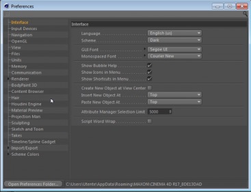

Posts: 10637
Hi Gwerilla,
sorry, forget to mention that the User Library folder is hidden by osx.
In Finder menu, you need to press ALT and click on the Go entry, in this way you should see the icon of the Library folder.
Another way is to open the Preferences in c4d and press on the "Open Preferences folder" button:
Happy rendering,
ciao beppe
