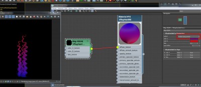

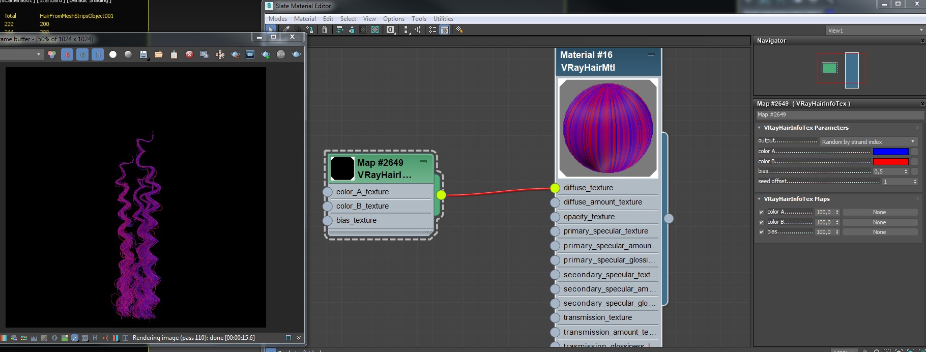

1. I cant render gradient hair by strand index in Octane and Ornatrix.
Here is my material and render.

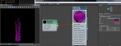

This an example with Vray and the same gradient =)
As you can see - An each strand have red or blue color. How I can realize this in Octane???

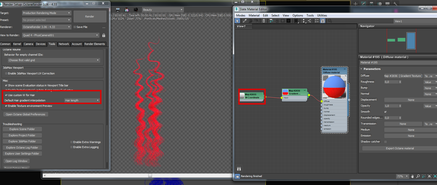

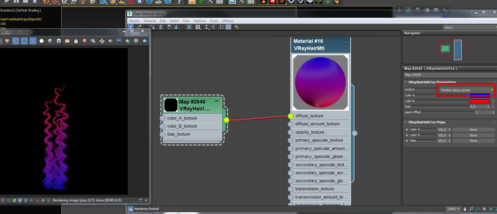

1. With Vray we can select the 2 Options:
a) Position along strand and have this result:
In Octane 3.06 - 4.33 - I can't create this...
b) Random by strand index and have this result:
In Octane I can't do this =((
