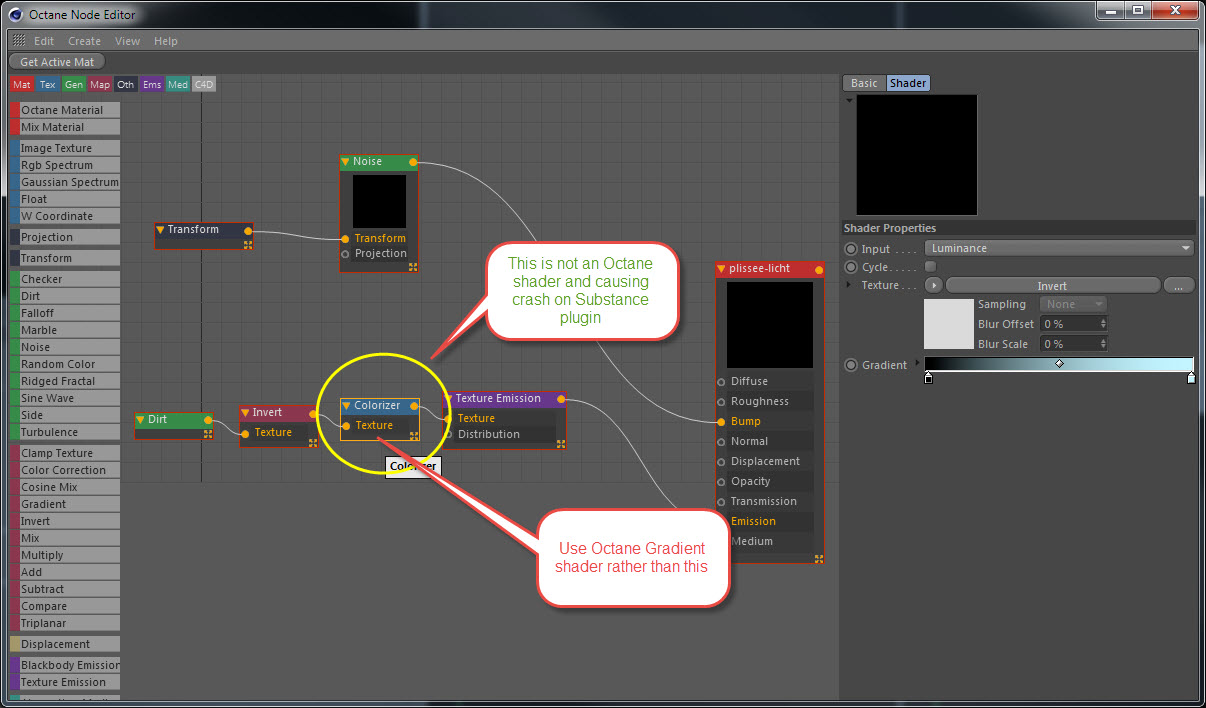

Here is what i found

philmaron wrote:Oh my, I thought Cinema Shaders (especially colorizer) were supported?
Nonetheless, an old scene when I did not use the gradient. I will replace the colorizers. Thank you for your quick help so far, this might really save me!
I don't say that there's no support. A kinda supported yes! I'm converting them to Gradient node automatically while converting whole materials to Octane materials. Issue is not that supporting them but there's a crash which is not directly related with with our plugin.
