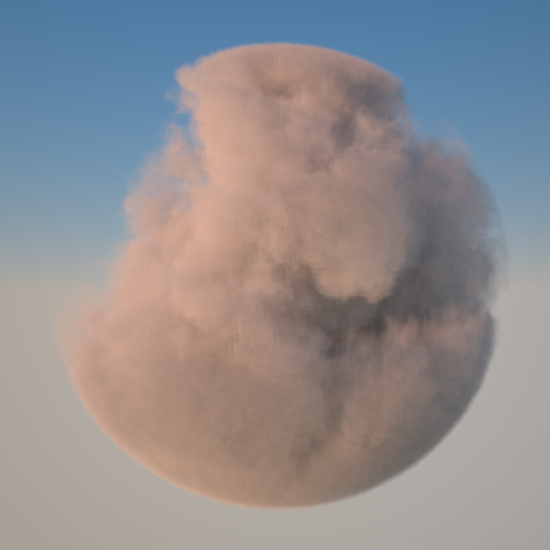

Something like this?
sphere-smoke-test.blend
(1.17 MiB) Downloaded 377 times
I'm getting some banding so you will need to play around with the settings some. I generated this at 128 resolution, you might want to go to 256 but it's going to run the simulation really slow. As it is now it takes my system about 12 seconds a frame to simulate the smoke. I'm sure there are better methods for this as well. :)

ooooooooooooooooooooooooooooooooooooh! I was supposed to put it in the volume output and not pipe it through a shader like I normally do with scattering. :lol:
Thank you for sharing this file with me. For some reason I was not even thinking of trying that.

I used your method to create this picture as a kind of test. So something came out of the discussion anyway, https://goo.gl/photos/ZJKG9sGYh7h156nJ6
Thanks for the help.
