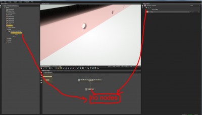

1. When I close Octane plugin it is till rendering in the background - my selected GPUs are still active.
2. When I create any component there is no nodal representative of it until I apply any material onto it. MY HUGE WISH - please give us geometry nodes that would represent SU geometry (groups, components). This would also serve as proxy source when replaced with external obj/ocs.
3. We have to have full functionality of mesh insert items - objs, ocs - instead of proxy in SU we shall be able to link obj/ocs in Octane and replace original geometry from SU.
* The Node Graph Editor (bottom left) depicts a "sandbox" that shows only the material nodes (and linker nodes connecting them to the geometry); the rest of the node graph (geometry, rendering options, etc) is hidden. You can manipulate the material nodes in the same way you would in the Octane standalone app. Can we have geometry nodes visible?
4. I still don't see the icons for kernel settings and all other icons to the right.
5. There is no other than "preferences" tab in the file menu - no save as orbx, save as default,... - is this intentional or will be added in next releases?
#1 is critical and #2 (and #3) stops me from using the plugin - we have to have visible geometry nodes (not materials only).
