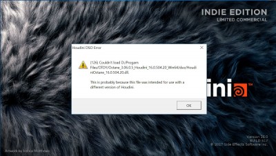

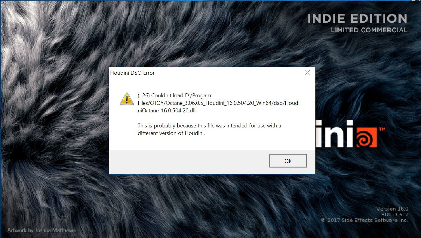

maze_vfx
Posts: 15
Joined: Mon May 22, 2017 8:42 am
I'm attaching a screenshot of the warning that I'm getting.
Did I do something wrong during installation or is it simply a bug?
Thanks again,
Jack
juanjgon
Posts: 8867
Location: Spain
You can't use the 16.0.504.20 plugin build with this version of Houdini because they are binary incompatible. You need to use the .557 plugin build. Please, modify your houdini.env variables to point to the 16.0.557 plugin build.

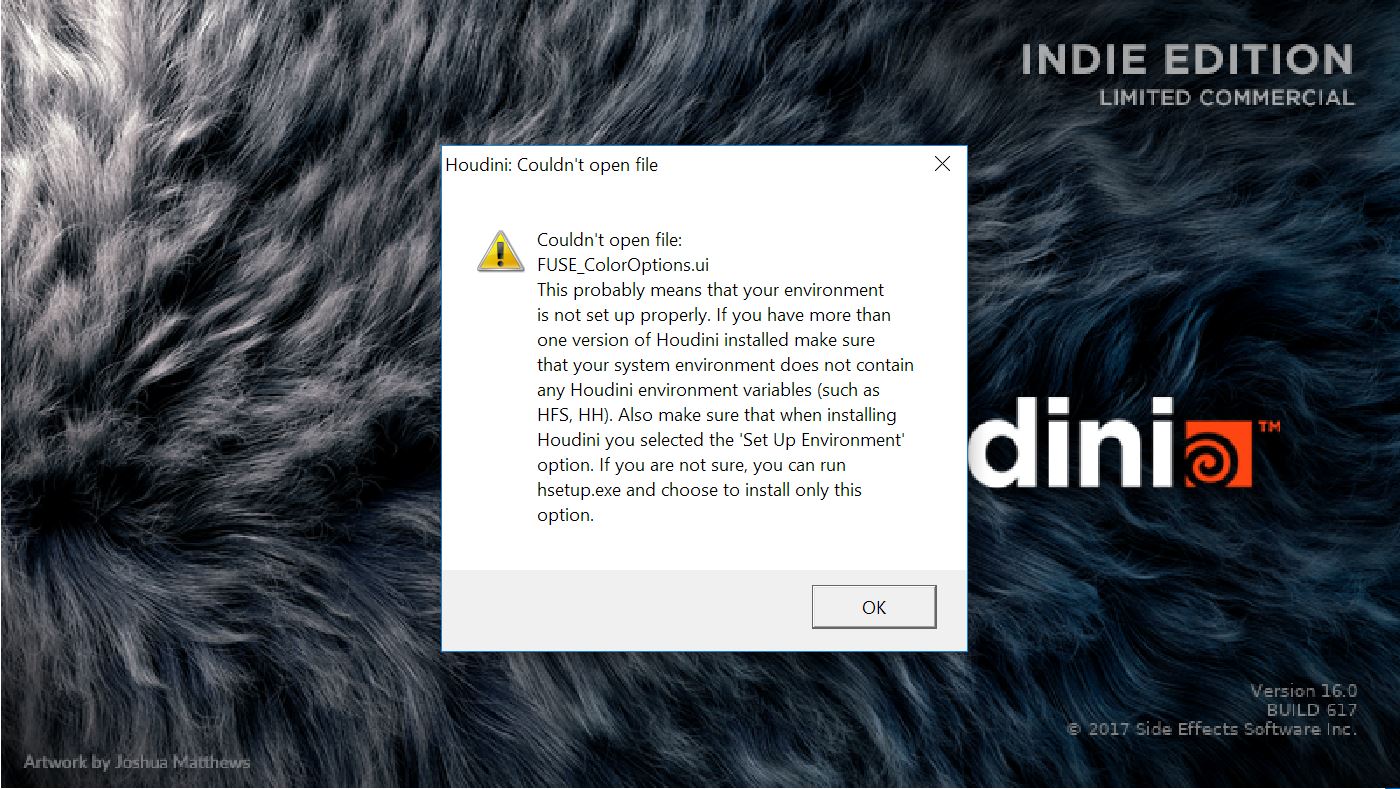

maze_vfx
Posts: 15
That solved that issue - huge thanks!
Another popped up though and only displays when I have the necessary paths to Octane in the env. file and not otherwise.
juanjgon
Posts: 8867
Location: Spain
This error is usually related to a type mismatch in the houdini.env file variables, for example additional spaces in the paths, wrong quote characters, etc.
Can you please attach your houdini.env file to test it here?
Thanks,
-Juanjo
maze_vfx
Posts: 15
Ok, thanks!
Yup, I'll attach the env. file - let me know what I screwed up haha
hindie_env.zip
(457 Bytes) Downloaded 308 times
juanjgon
Posts: 8867
Location: Spain
You file had several issues, like all the ;$PATH and ;& strings at the end of the variables. Please, check this one to see if it works now.
