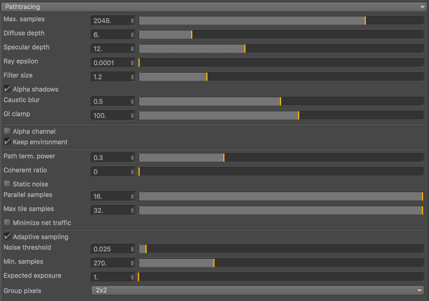

I have a small, but disturbing problem when working in live viewer and using network rendering. There are parts of the render viewer that are black while refreshing the frame.
Here is a screen recording: https://dl.dropboxusercontent.com/u/254 ... roblem.mp4
I am using the latest version of Octane and have 2 slaves with 3 and 2 gpu's. I am using 980ti's and 1080ti's. The probelm is the same even if I change slave/masters between them.
Here are the render settings:
Thank you!

I have discovered that if I decrease Max tile samples it works better, but still get black areas.

in general, I prefer tonwork with a very lower value of the Max tile samples while setting up the scene, and rise it to the max only in final rendering.
