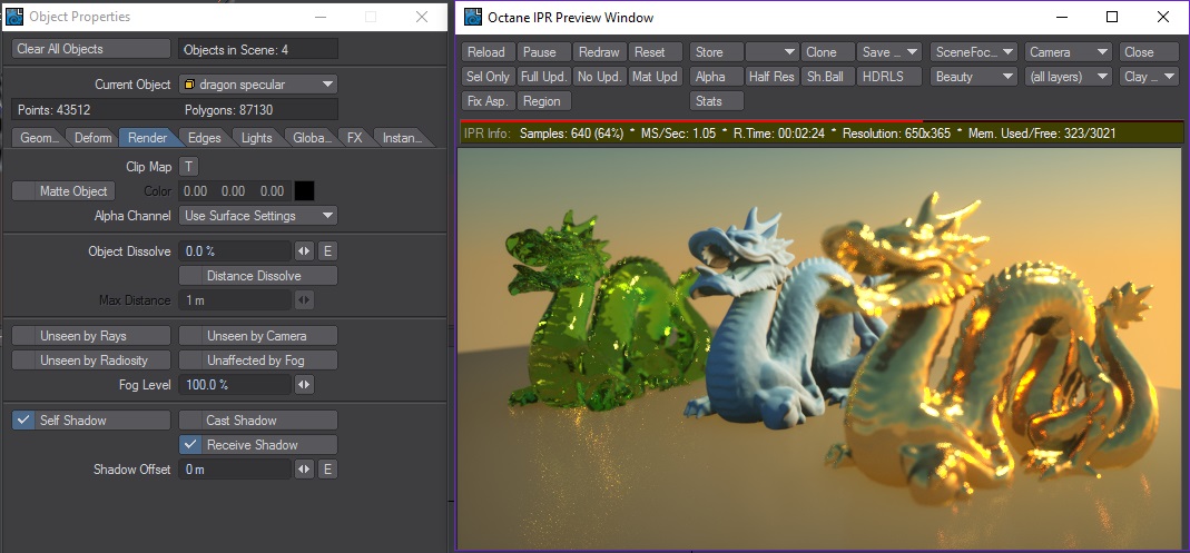

Is there any way in LW Octane plugin-in to tell an object to not cast shadows? I know that the "unseen by camera" checkbox in LW informs Octane to not render an object, but it still shows up in shadows. I noticed this thread for another plugin and was wondering if such an option exists somewhere in the lightwave version?

The "Cast Shadows" flag works with the Octane plugin to disable the shadows casting at object level.
