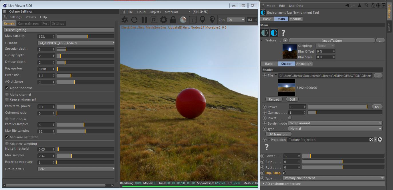

Normal HDR Environment:

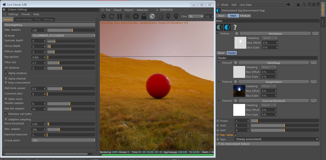

Filtered Primary Environment mixed with an orange color with falloff node, note that the shadow is lost, due to the absence of Importance sampling:

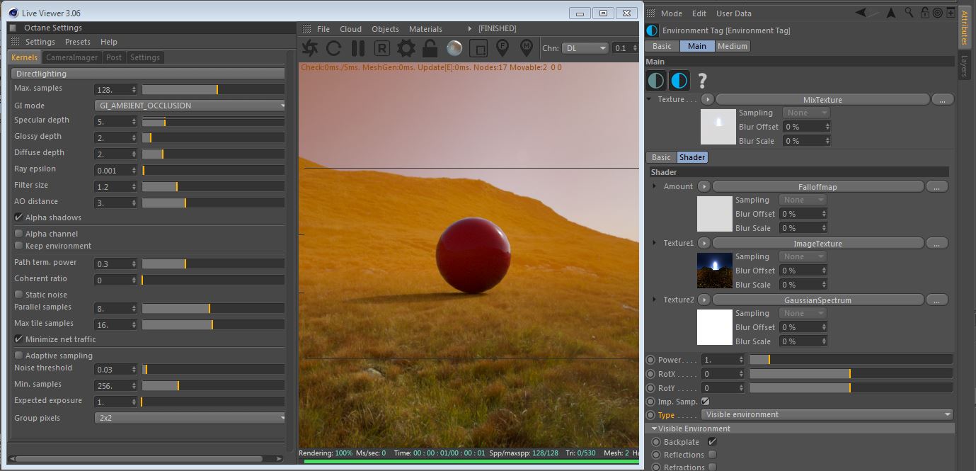

Filtered Environment in Visibility mode with Backplate option active:

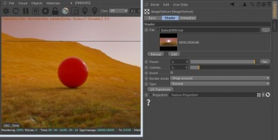

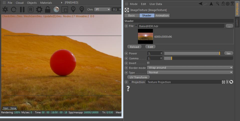

A workaround, without leaving c4doctane, is to copy the environment node in a new scene with Panoramic camera at 0,0,0 and save a render in Radiance HDR from the c4d save menu render settings option, then use it as primary environment in the original scene with importance sampling active and everything in the right place:
ciao beppe
