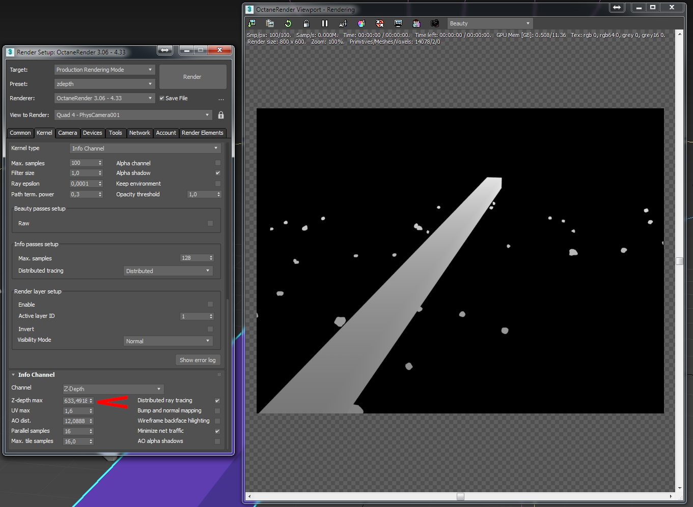

hi , thanks you for your reply , but it don't work !
http://i.imgur.com/bc8bbL0.png

so strange ! i don't use particle shape , i use geometry , can be this ?
i attached my project here !

Zdepth works properly; you have to adjust the Z-depth Max value.
However, it always depends on units of measurement, your scene measures 500 mt, I do not know if this is a real or not.
