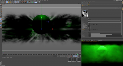

Hi guys,
It has been asking several times, I know.
Some of you were annoyed to answer again and again to this, I know.
I'm sorry I might be a little annoying but I can't get it to work.

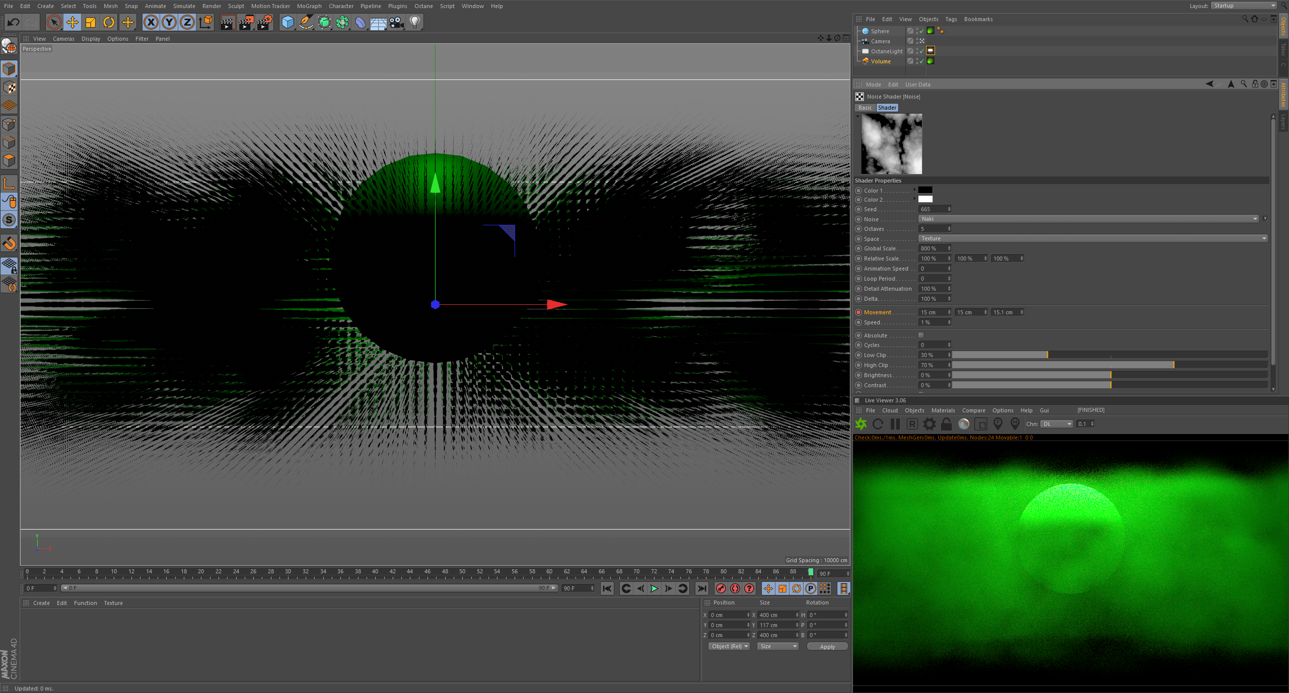

If you look at the attached picture, I want to move my noise along some axis to simulate some kind of wind force on the smoke.
"Animation speed" is nice but it changes the noise in a static dimension.
I am interested in the "movement" setting, as i was used to do with c4d native noise shader without octane.
As many of you answers, I keyframed at the "movement" setting at the beginning of animation(15 cm for exemple) and keyframed again at the end of animation (15.1 cm) to trigger the refresh of Octane plugin. Nothing moves in the live viewer.
Could someone post something more detailed with some screenshots or video to be sure i didnt miss nothing ? That would be awesome ^^
Thanks !

Yeah, I've been searching and playing with it all weekend and i figured out the noise shader need to be in 3d space, which c4d noise shader is not able to do with octane (as it is converted as a UV texture).
I tried to use native octane noises shaders (even if interface is not as good and as complete as c4d's one) and i could get a result close to what i was looking for (by animating the offset with the turbulent generator for example).
As a newbie that was a good self lesson for me.
