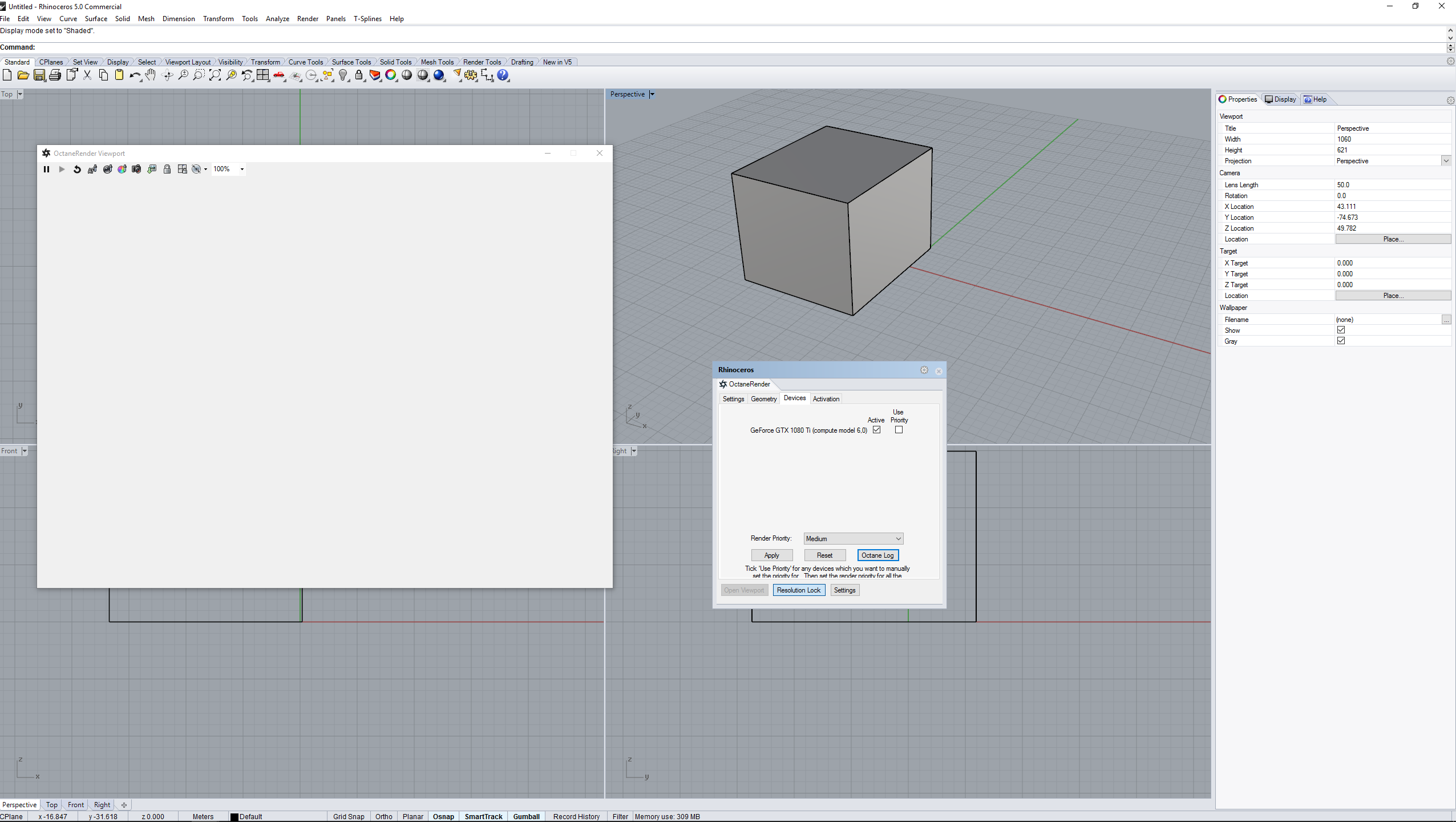

I do have geometries in the scene. When I open the log this is what i get.
'CUDA device 0: Failed to find a CUDA binary matching compute model 6.1'
vincentdrolet
Posts: 8
Joined: Wed Mar 29, 2017 1:49 pm
This is what I see...

I just realized that de version of octane render for Rhino is 1.05. Could it be teh reason?
I doubt Octane 1.05 would work with modern graphics card - so I think that is your problem. I suggest you update to Octane 3.
This confirms that your graphics card is not support by Octane 1.05.

Works fine now. Version 1.5 was the issue.
