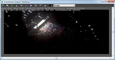

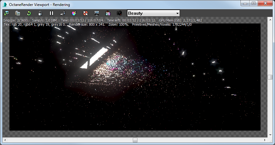

Having a Problem here,
the OctaneRender Viewport Stops at 2 Samples and keeps counting the Time Up.
This seems to be the problem on in "Beauty" Mode all others work fine. Tried reinstalling and Updating Drivers. Same error
also when selecting Region render the same Problem occurs. Only when moving the Region Render Frame it clears up and samples go up.
Also when clicking the Dropdown Menu and selecting Beauty (although its already selected) it goes from 2 Sampes to 16 and so forth
Normal Rendering of the Scene works fine. Only the preview wont render
Octane Render 3dMax 4.33
Max 2016
GTX 780ti Driver 382.05
Octane Render Viewport Stops at 2 Samples

its lit by an hdr only so there would only be a camera in the scene file
also noticed when the material editor is open and i click the different materials the Viewport render also jumps up in samples.. strange issue

Found the issue and its Fixed.
my camera exposure is 0,5 so i checked in the Kernel settings under "expected Exposure" 0,5 this caused the problem.. changing it back to 1 solved the issue
