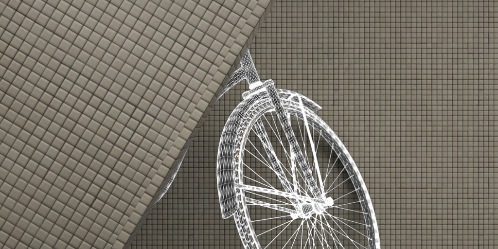

Hi vincentdrolet,
I have just tried to copy the position values of a Standalone Thin Lens Camera, pasted into a c4d camera, and it seems to works as expected.
Note that the c4d values are in cm, while SA works in meters, and the z value needs to be flipped. Finally check to have the same Focal Lenght value:
c4doctane camera from SA data
standalone camera wireframe over c4d camera
