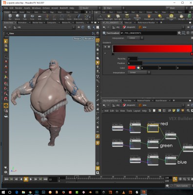

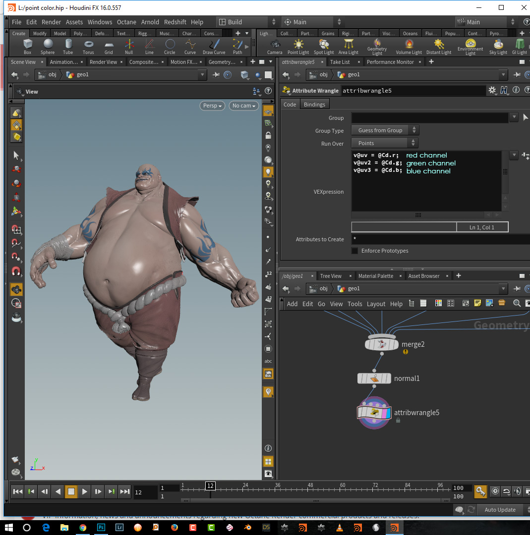

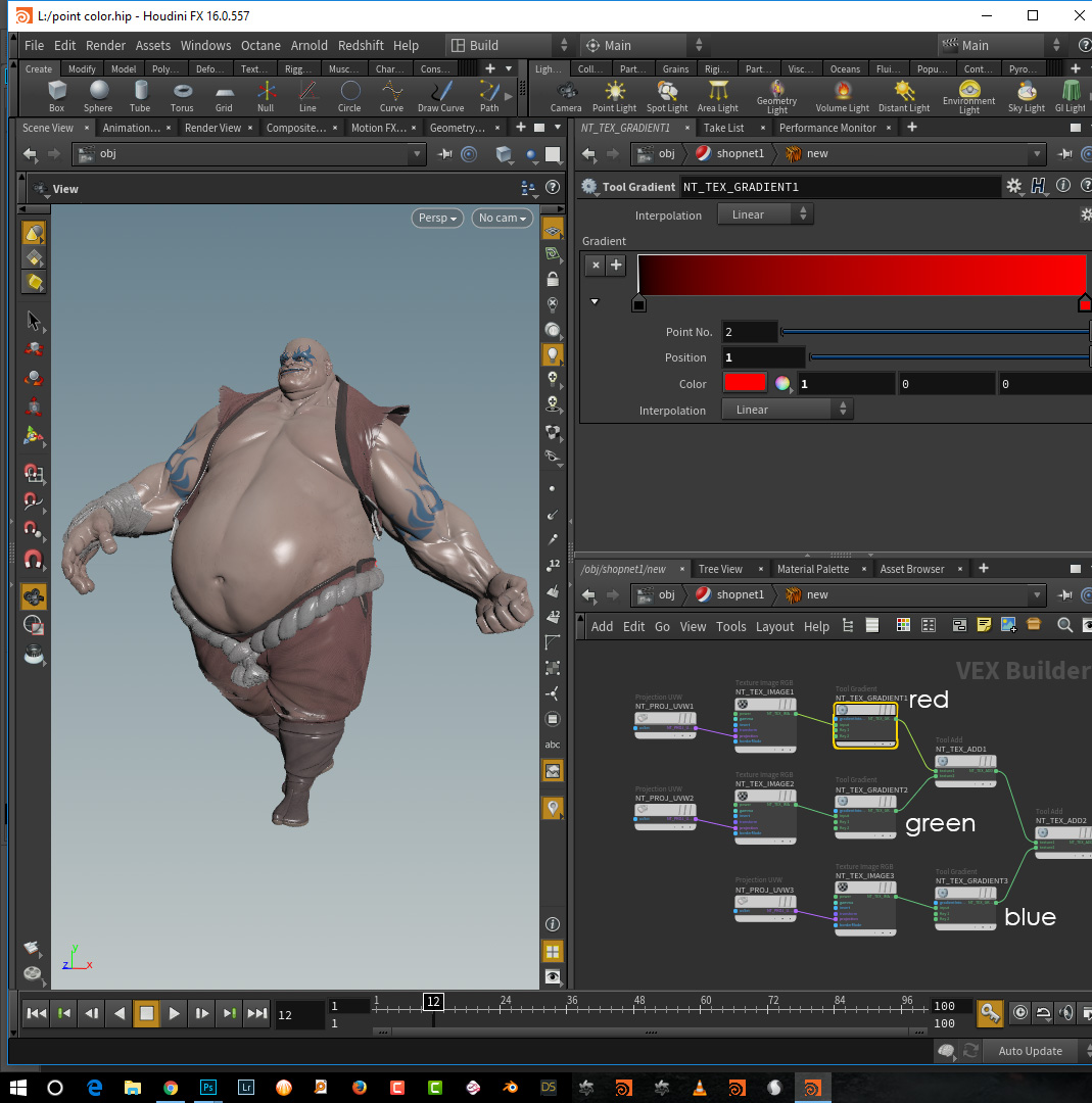

rohandalvi wrote: Could you post a screenshot of you node tree.
Anyway it's way easier out-the-box in Houdini as in your example,
But it seems you're only using the V coordinate, maybe your VEXexpression should be more like this to use both U and V coordinates: ( Alpha component might be specific to Maya Vertex Color )
No split is needed you can composite back the colors in one texture exactly the same way you do it in your example,rohandalvi wrote: Also how do you split up U and V to drive separate textures. The meshUV node only gives a single output?
except that for U gradient (for Red and Blue channel ) you have to add a tranform node with 2d rotation of 90 degres (or use a different gradient Image already U oriented).

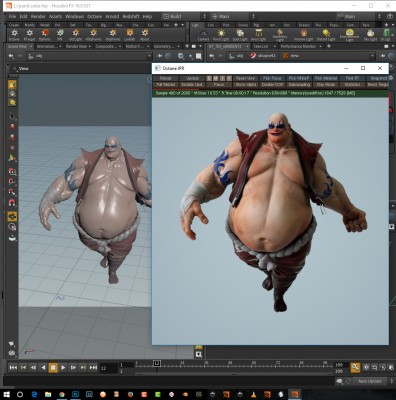

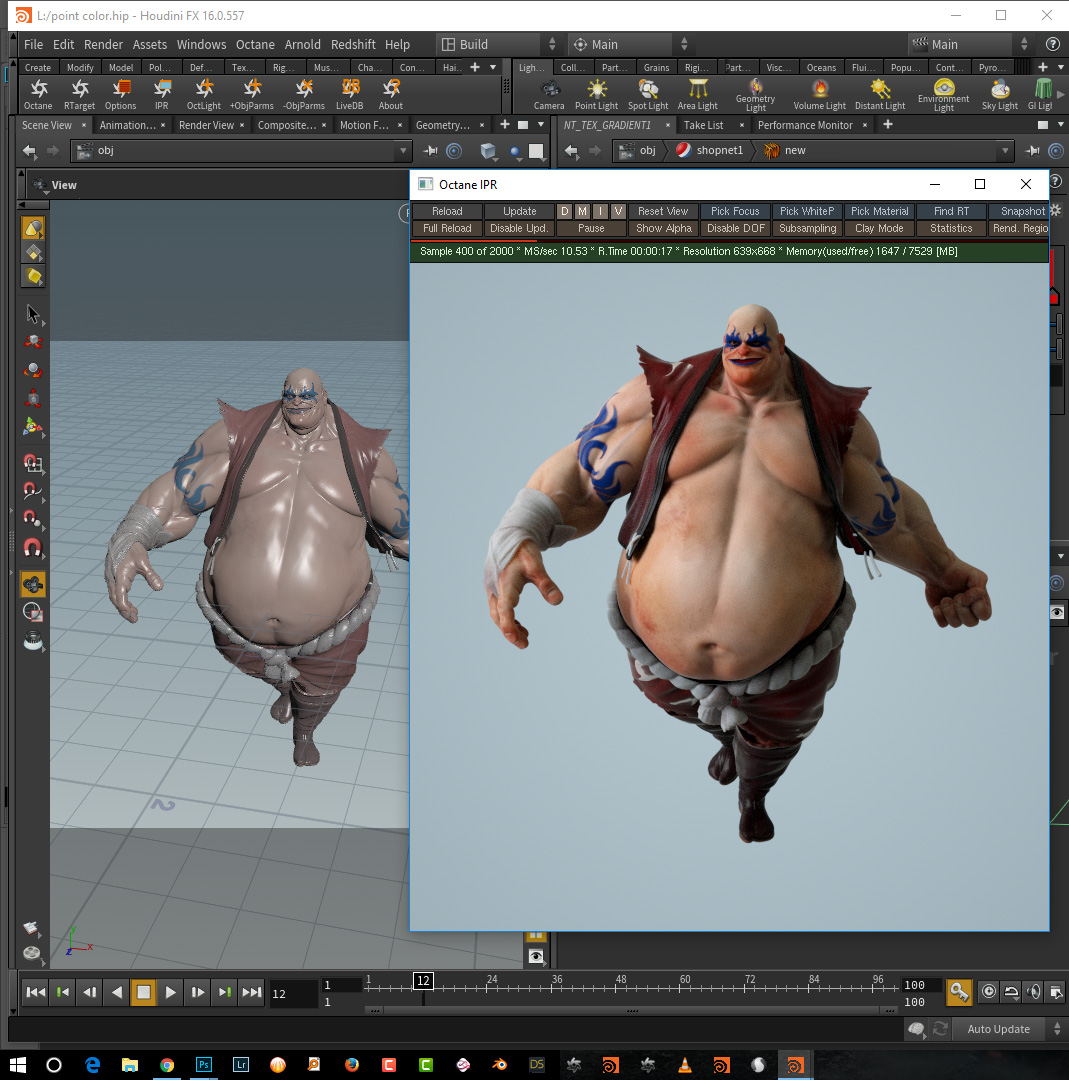

Thanks a lot for your help. It worked.
Now I have one UV channel free.
When I make a video of this, I'll definitely give you a credit.
