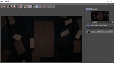

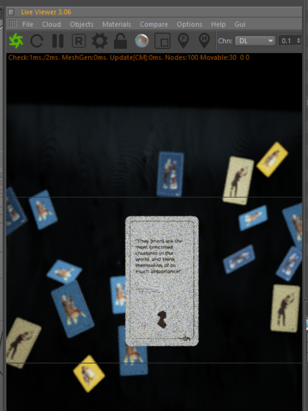

Hi guys,
I try to render a simple scene in Cinema 4D R18 in Octane render 3.06, but it seem the picture viewer could not load the texture images correctly but in the Live Viewer window, they are totally fine.
As you can see in the attachment.
I'm new to Cinema 4D and Octane render, could you please help me figure out why?
Thx a lot.
