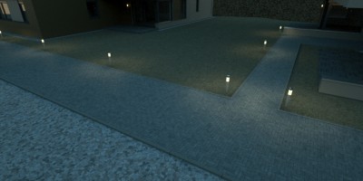

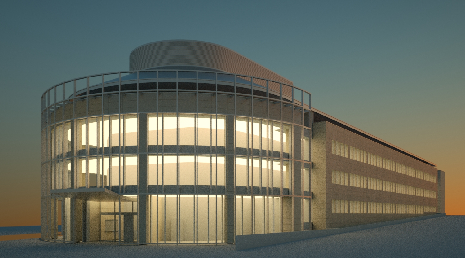

Pic 001: Here you can see the light sources as the material’s opacity is set to 1.

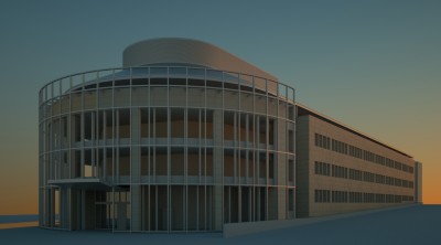

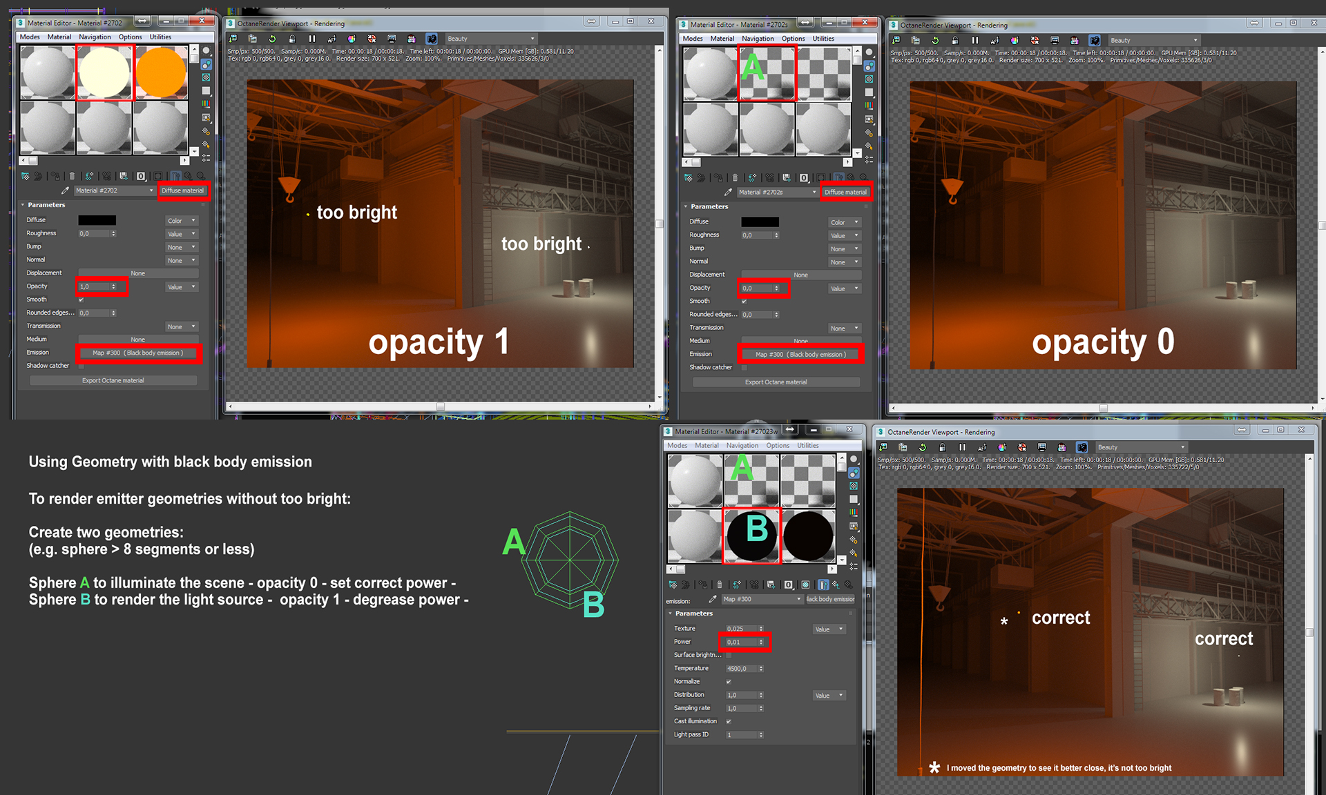

Pic 002: On this pic the light sources are hidden by material’s opacity set to 0. Now you can see the light intensity decreases considerably and the spot on the ground directly under the surfaces is dark as if the surfaces would cast a shadow.
How can I solve this?

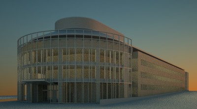

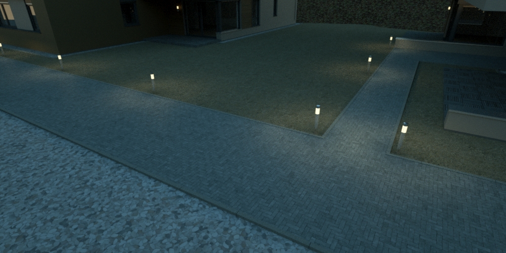

Pic 003: Lights are working good here. Material opacity is set to 1 so you can see the light sources. Power of the light is 40.

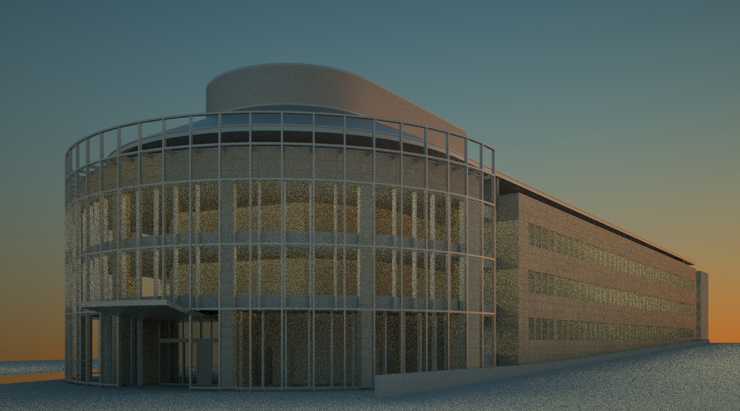

Pic 004: Also power 40 but material opacity set to 0 to hide the light sources --> You can see that the light intensity is now so low that you don’t even see the light.

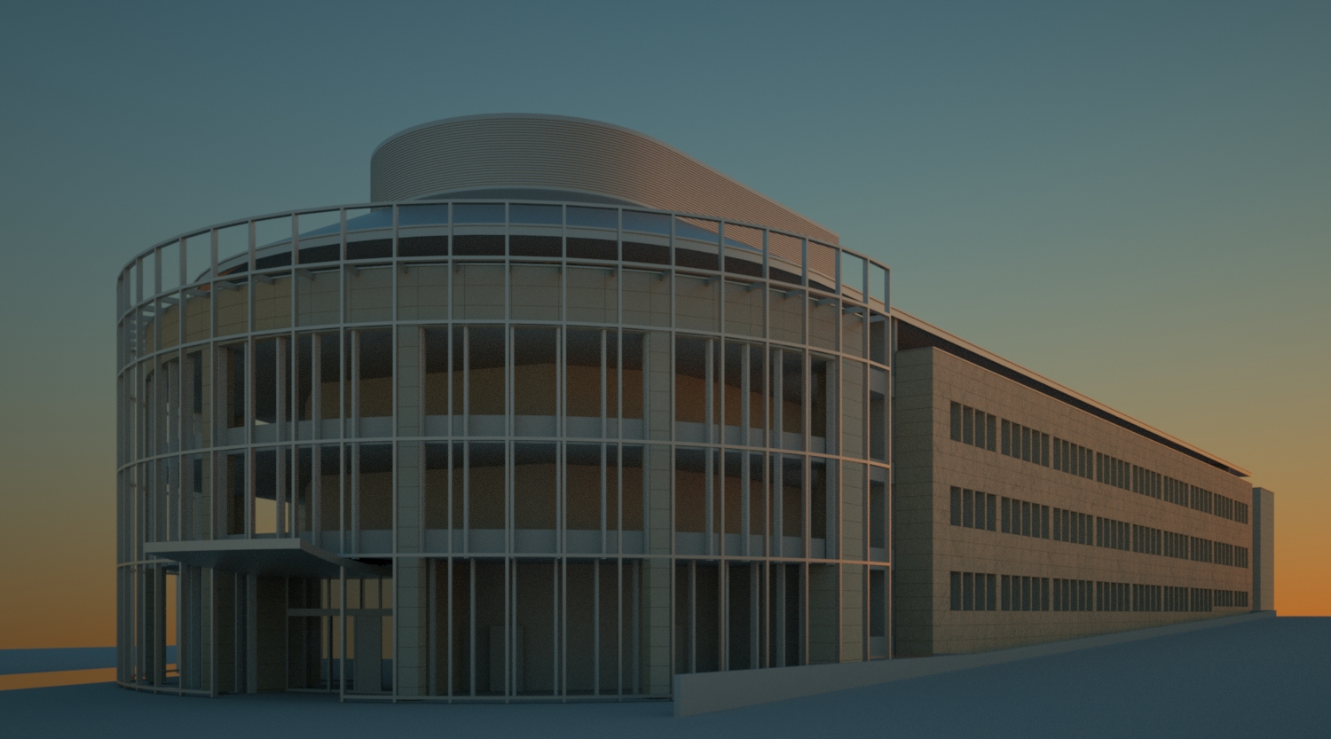

Pic 005: Opacity is still set to 0. I increased the light power to 1000 to see if the lights still work. They do but now they create a lot of hot pixels.
I noticed that it works without problems on a small surface. But if the light surface increases, the error starts to occur.
