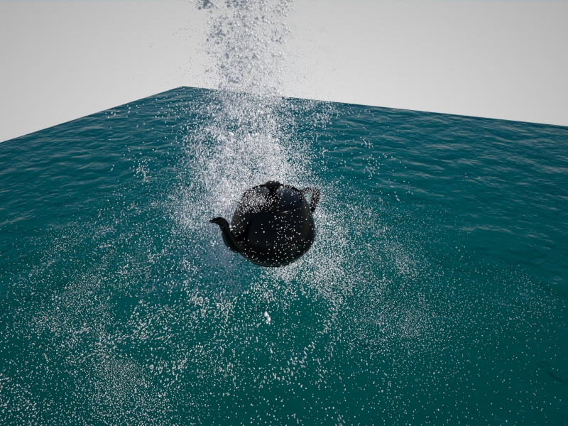

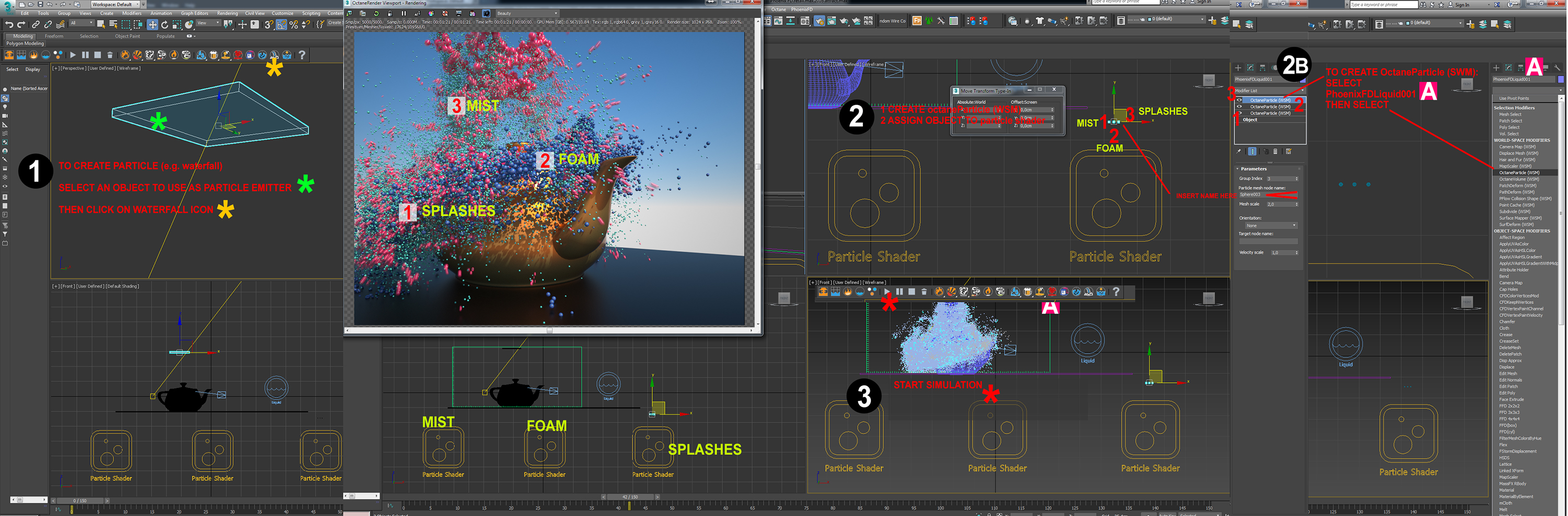

Attached a screenshot with a how-to for Octane 3dsMax and Phoenix FD particles
Regards
Paride
Phoenix FD Particle and Octane 3dsMax plugin
- paride4331

Octane supports Particles, splash, foam and volume; developers will fix PhoenixFD RGB chanel soon.
viewtopic.php?f=27&t=68430&p=343781&hilit=+wsm#p343781

damn, still can't get phoenix fd working - does it work on 2018.1 beta 4 - can you do some tut demo / .max file to test out a working one? Just want to do simple smoke or water.. using the tire burnout demo from phoenix fd
EDIT: Sweet finally works, just popped the Octanevolume wsm on top of the smoke sim, added colume medium, raised the scatter to white and it's there - from the new 2018.1 7.04
