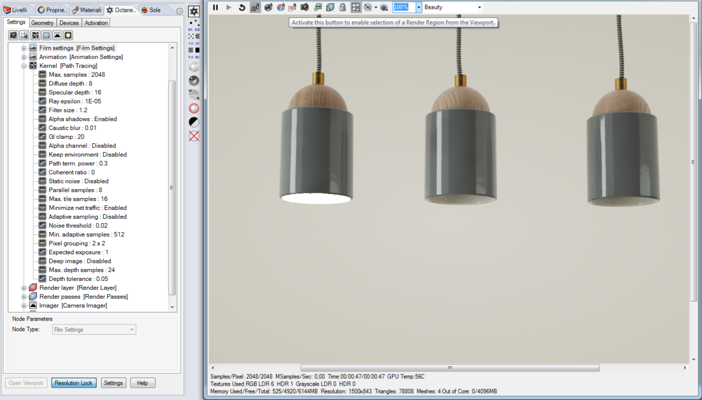

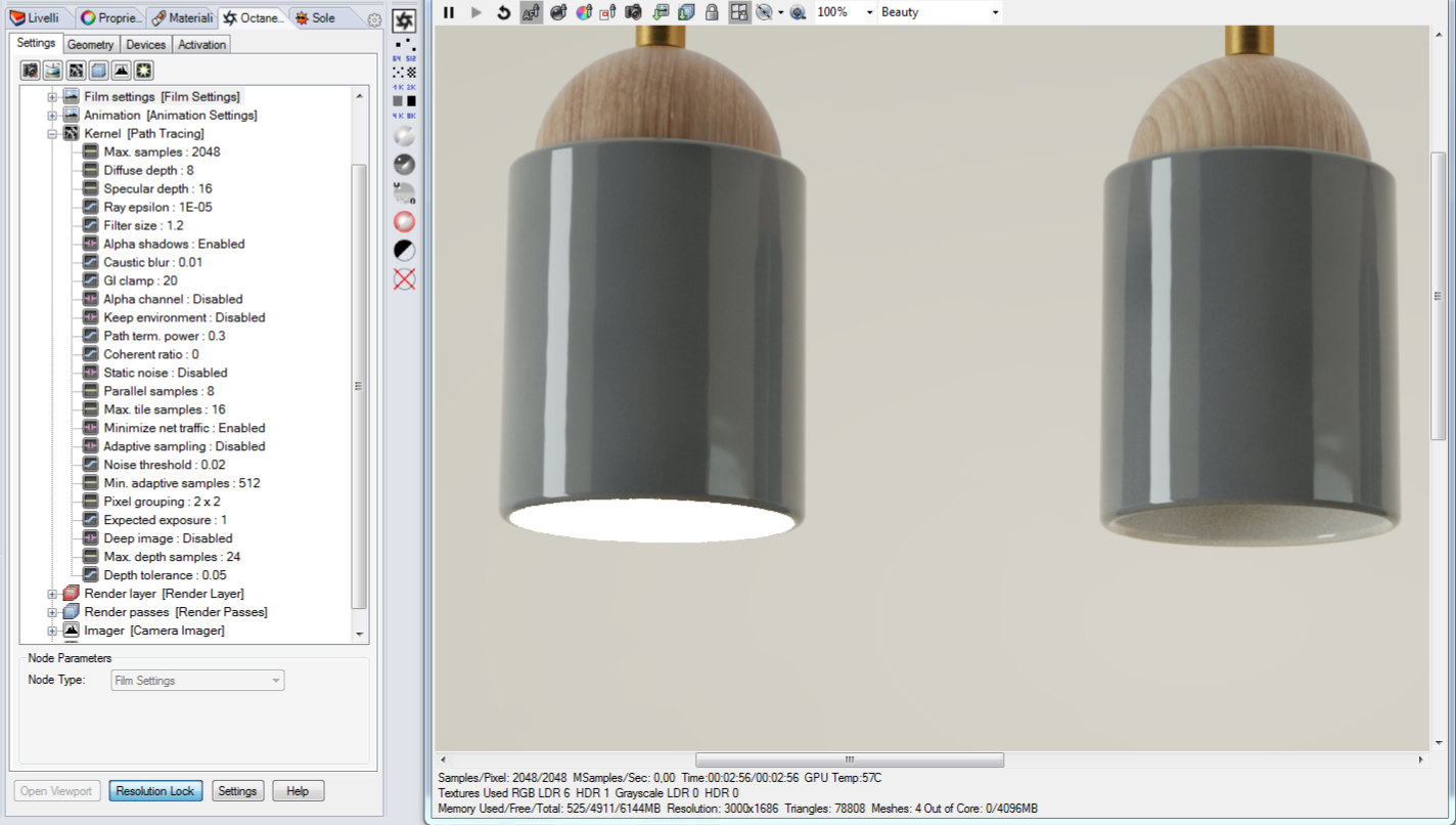

I put a simple light sphere inside a pendant lamp but the result is a jagged image . I tried to increase the resolution but I get the same result.
Any idea?
Thaks in advanced
fabrizio

Hi - I think this is an issue where anti-aliasing is not applied to geometry emitters. You can increase the Kernel->Filter Size to diminish this effect.
Paul

I tried to increase Filter Size but nothing..

what about reducing the emission intensity

Yes,
the image gets better!
But why?
thank you
fabrizio
