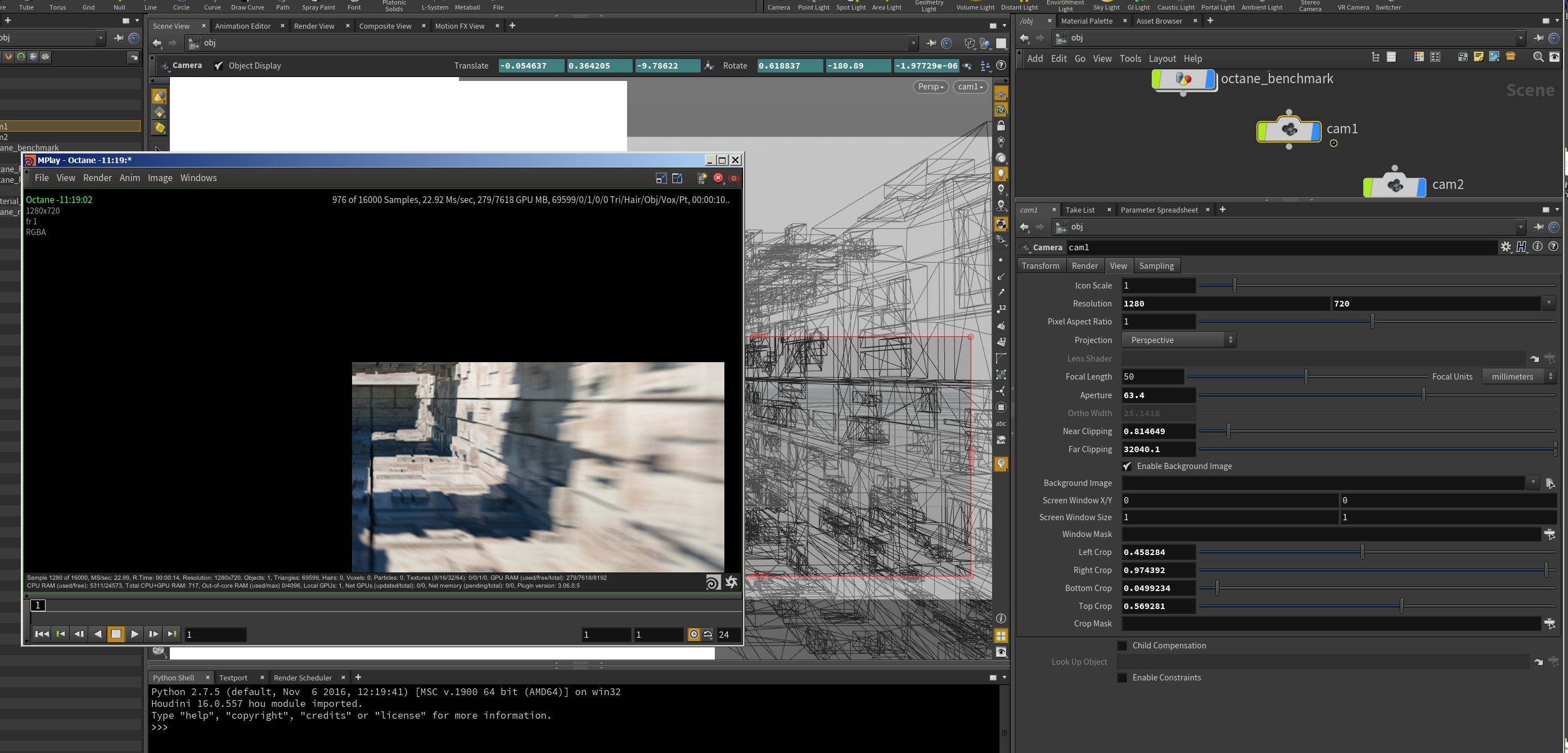

I try to recreate the same template scene from C4D to Houdini.
I render with Panoramic Camera and i crop the part i need. For faster result i use Region Rendering.
But i can't find this option in Houdini / Shop / RenderTarget / Main (it's when this option is in Octane Standolone and C4D)
i am not talking about Render Region in the IPR, but in the final result render.
Thx
Main / Render Region (not the IPR)
Moderator: juanjgon
The render region for the final render is set using the Camera crop parameters, like in Mantra. You have the crop options in the Camera node, View tab, or you can set the region in the viewport interactively selecting the Camera and with the mouse cursor over the viewport (looking through that camera) pressing Enter to get camera handles.
Thanks,
-Juanjo
