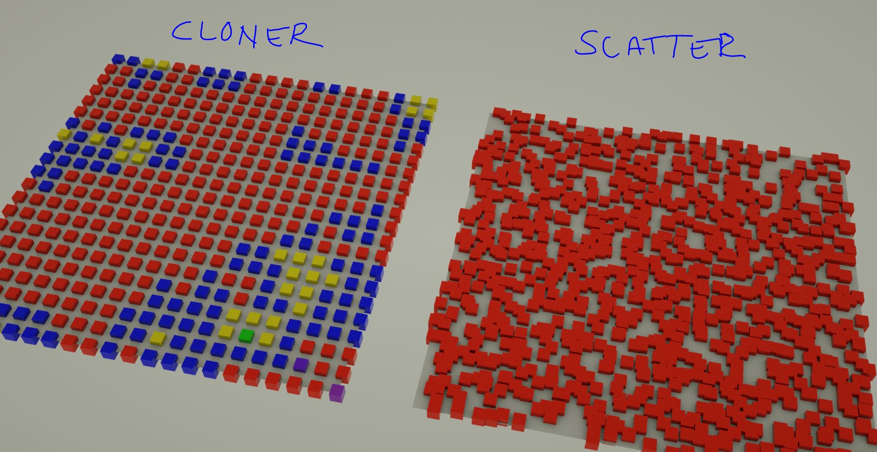

is there a way to get the multishader running with the octane scatter object? Or is there a workaround/proper way to achieve the same result?
It even just works with render instances checked off (on the cloner), so my scene gets really heavy..:)

Cloner with render_instances and scatter object, both are resulting same structures at end. Only randomcolor can work with that not any mograph things.

aoktar wrote:Cloner with render_instances and scatter object, both are resulting same structures at end. Only randomcolor can work with that not any mograph things.
Too bad..:)
But thanks a lot for the really quick answer!
Cheers
Posts: 16067
Location: Türkiye
It will work when Otoy guys added a new texture type for instance colors.
