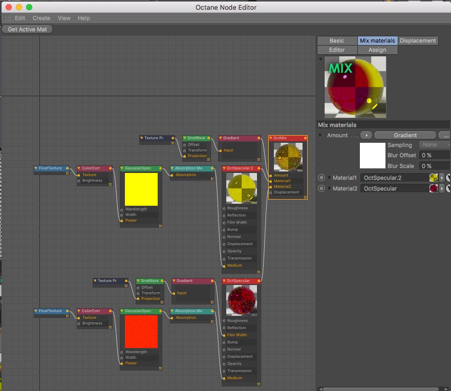

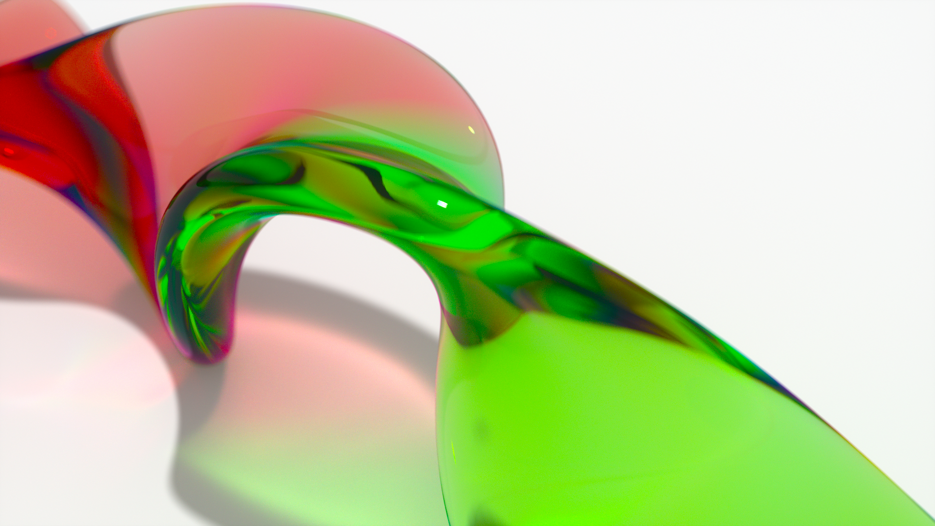

Hi imurdochd.
here is my attempt with mixing two specular materials with a gradient in the amount:
playing with absorption, index and film, you can obtain different effects.
