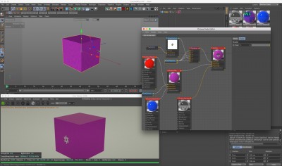

can someone explain how the triplanar node works right?
I just tried to use a imagetexture with the tirplanar node in the diffuse but it´s not working (see screenshot).

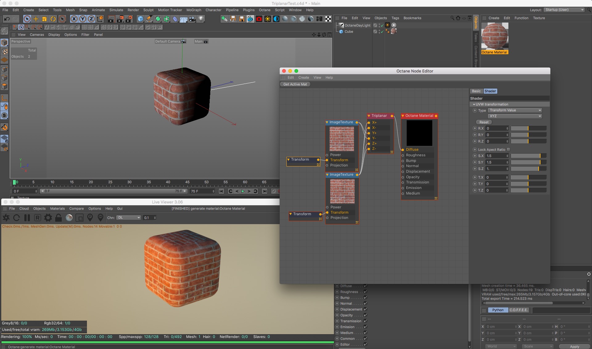

Hi Chillkroete,
if you use the same texture without any modification, the Triplanar node is useless.
Please, look at this fast example where the Y texture has a different transformation value:
TriplanarTest.zip
(400.99 KiB) Downloaded 176 times
ciao beppe

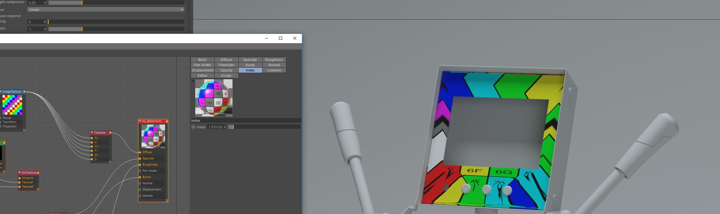

Here is another example for restricting a logo only in one direction in the amount of a Mix material:
ciao beppe
