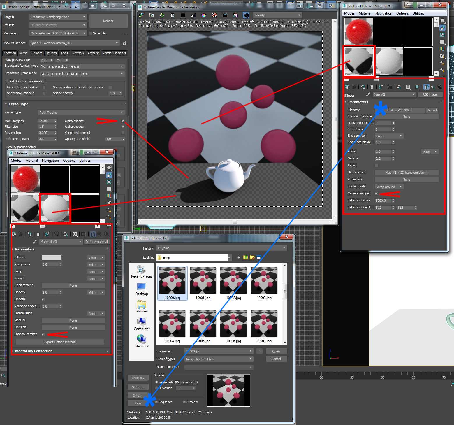

Hey guys, I recently bought a subscription for OctaneVR for 3ds Max and am currently working on a project that requires 3D geometry integrated with live action footage. I've done this before with Vray a couple times, but don't know how to do it on Octane. I am trying to have shadows correctly placed into the scene. How can I do this and have the my 3D elements and physics react with the scene geometry? Thank you

Hi dandoozled,
Attached a screenshot with some useful elements around your needs.
Regards
