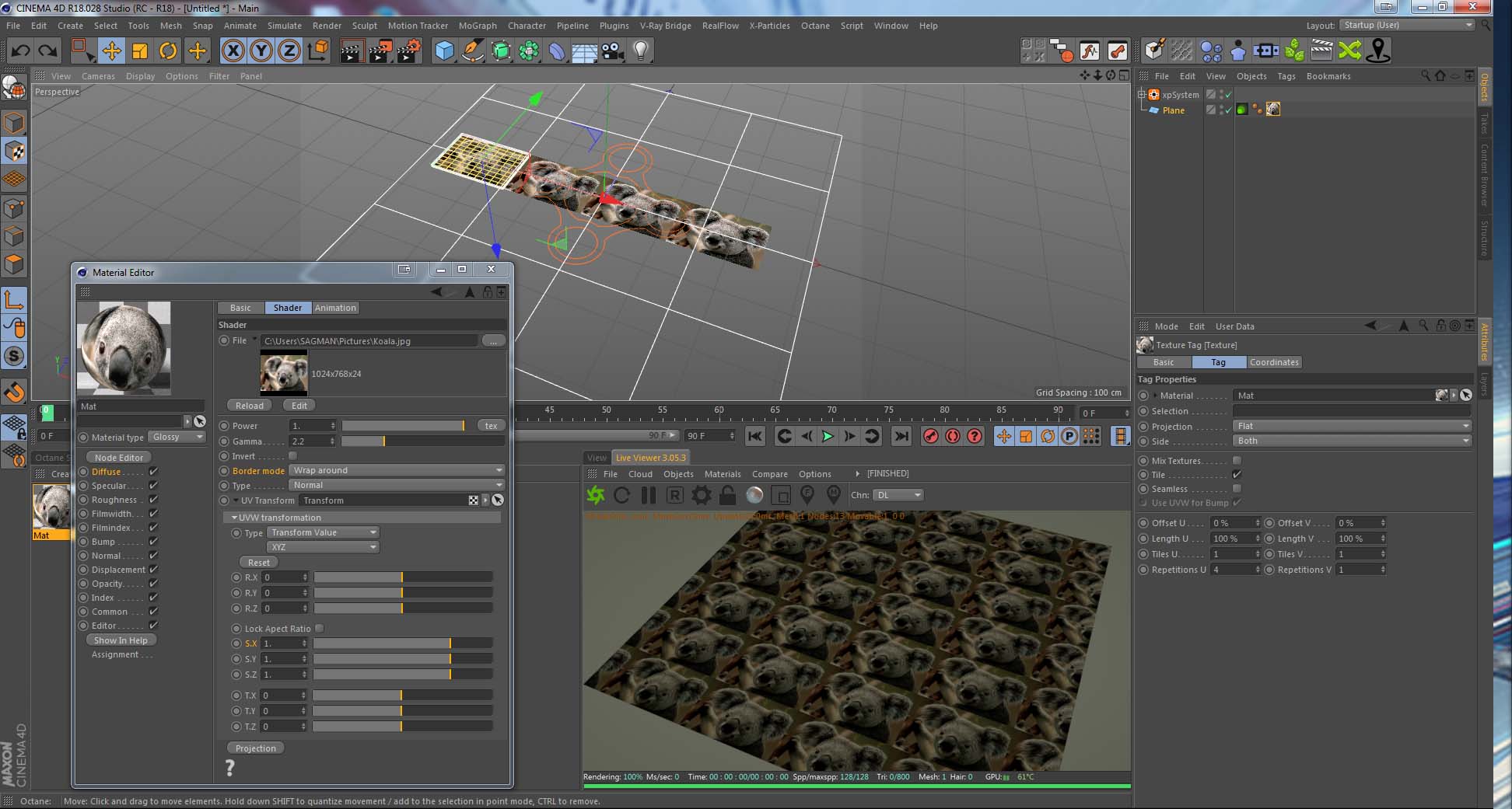

Also I tried to use multiple texture node and offset it manually inside a layer texture but the border to "black color' is not working ? Does octane have it's own layer texture node ?
Aslo, on a side note, there is no repetition count too and the texture repeats in both u and v direction to cover up all the surface unlike c4d. This is forcing to make use of uv maps which i'm trying to avoid because of several reasons.

Why do you use c4d native textures? They are rendered in cpu(before gpu rendering) as images and used like that. It will not work as a real procedural. Also that's not a good idea and try to use octane nodes rather than these. And Octane has not a layer node but you can use mix/multiply/add/subtract/etc.. to get what you want. You have to wait OSL version for much flexible texture/material system. When OSL out i believe that writing the custom textures/materials will be possible.sagun wrote:Also I tried to use multiple texture node and offset it manually inside a layer texture but the border to "black color' is not working ? Does octane have it's own layer texture node ?

Thank you very very much for showing me the path. Add/substract/multiply was completely out of my mind. I will try to adjust with that for now. Also will wait for OSL shader and try to research about that too since this is new thing for me.
