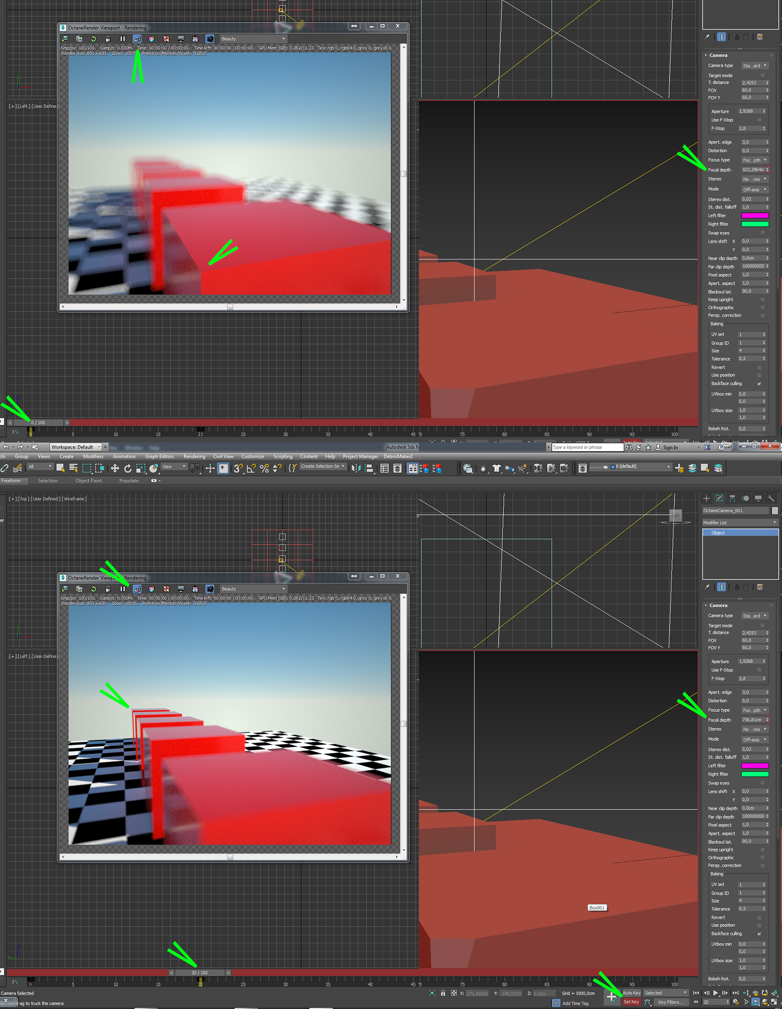

use octane camera and animate focus. I hope 3ds max dev will make focus animatable inside Camera tab of octane render dialog. PLEASE We just don't like octane camera and sue standard a lot

To animate the depth of field you have to make exactly as you animate any other element in 3dsMAx.
It is also easy to use Octane focus picker.
