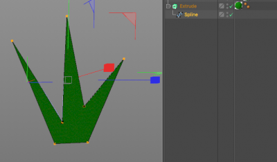

However.. if i recreate a scene like that and use simple geo to create the grass form, instead of an alpha.. the render times drop back down to very reasonable 3-5 mins etc.

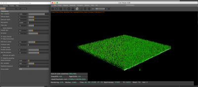

I've taken some screen grabs of a very simple setup to illustrate my point.
Heres a set up with Geo defining the grass, not an alpha. very reasonable render time of 31seconds.

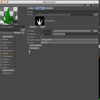

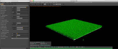

But then i use an alpha on a 1x1 polygon to define the form.. pretty much exactly the same in every other way. and the render time jumps to 21 minutes..
