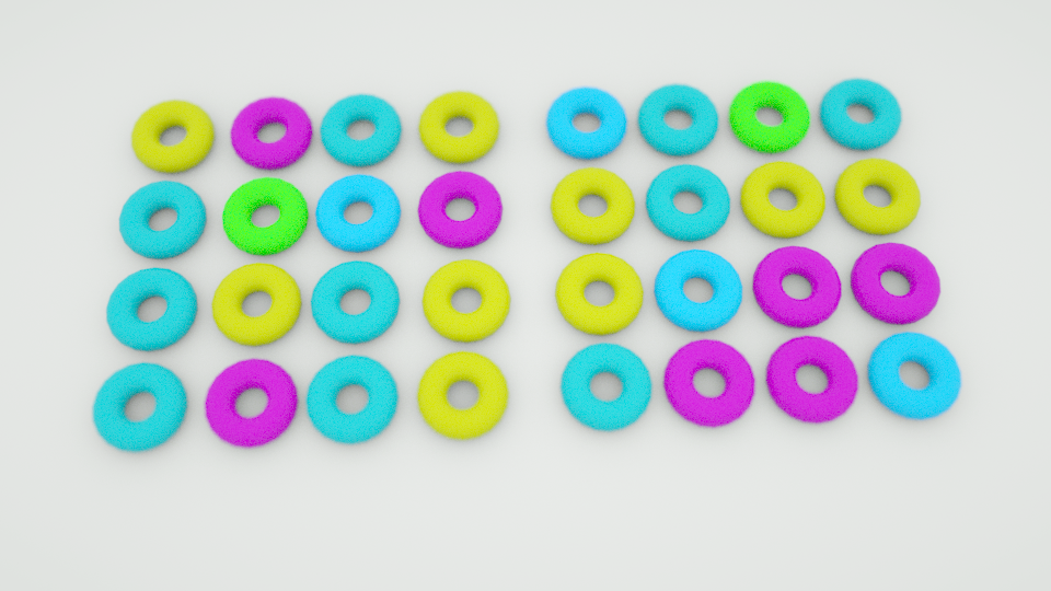

When I open your file and render it, as you can see I don't have the same result as you,
this is because the "Virtual Material" feature gives unpredictable result depending on what workstation it is rendered on (also other factors I suspect).
this feature might seem to work for simple test but it isn't, just make a little more tests...
As a result Virtual Material is not usable in a production environment because network rendering triggers unpredictable results.
On top of that you use 6 materials with 6 different ramps, to achieve a 4 color variation, do you realize that this kind of setup is unusable on real work production,
with hundreds of objects and variation needed ??? What is the point of using this buggy uncontrollable feature ?
Also do you realize that this result (without the bugs) is done and edited 100 times faster when not using Virtual Material but using only one material one gradient and one Random Color Node ?

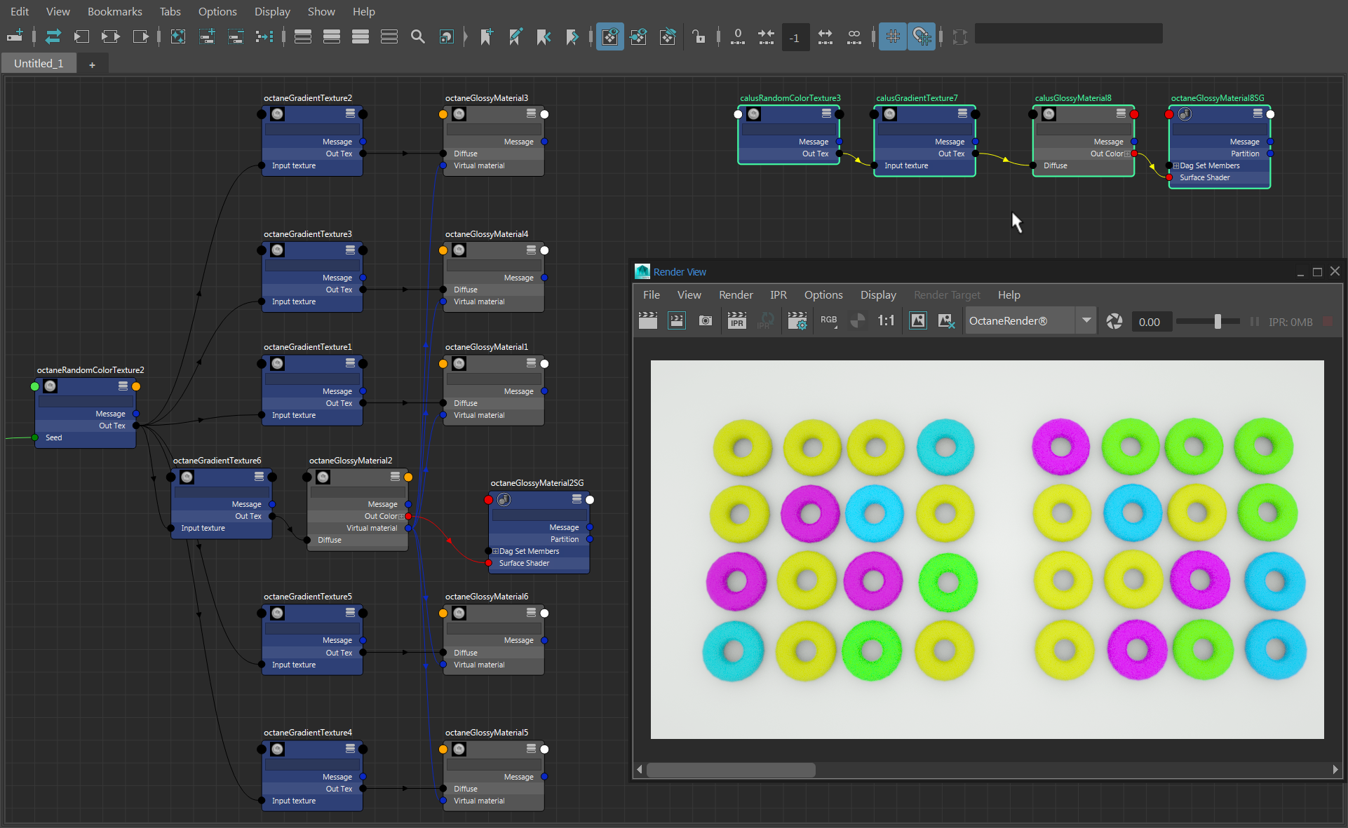

in this scene you can compare on simple objects :<br /> on the left, your Virtual Material setup with mutliple nodes,<br />on the right the same done in few seconds with only 3 nodes !!! (random color node workflow)
random_texture_calus_compare.zip
(59.26 KiB) Downloaded 443 times
Random Color Node works with regular meshes, or with instancers, and have control over everything, unlike Virtual Material where basically nothing is controllable.

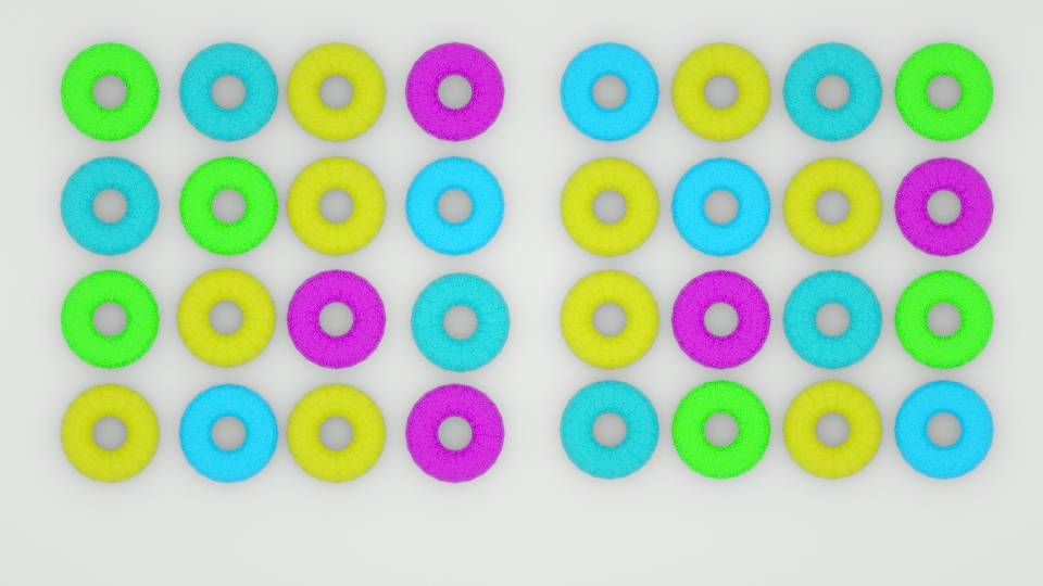

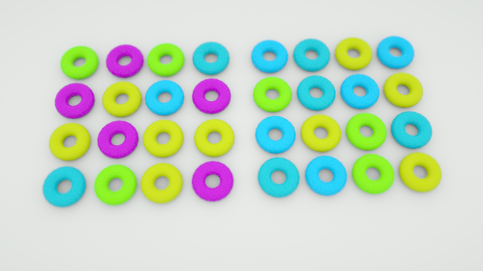

BK wrote: open your scene and tick the non-permanent object material then it should work.
That was not my point,
and I still don't have the same distribution as your render with "non-permanent":
Indeed the randomness is even changing when I change frame and come back to the same frame.
As this is not a predictable behavior this is a useless feature, do you understand ?
I explain one more time: randomness in an animation software must always be deterministic,
a feature in Maya that gives a different result the second time you render it, is just useless.
