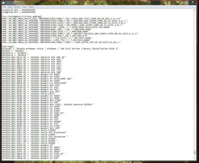

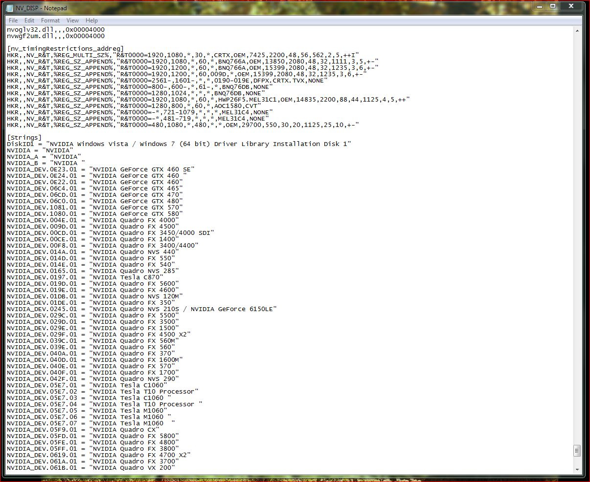

Does not seem as if the forum will let me upload a file with the .inf extension.
hence the problem with the upload
you may have to do this manually.
find and open the NV_Displ file within the quadro display driver folder in notepad and add the names of the geforce cards as per the screen shot i have attached.
Then save and close the file.
