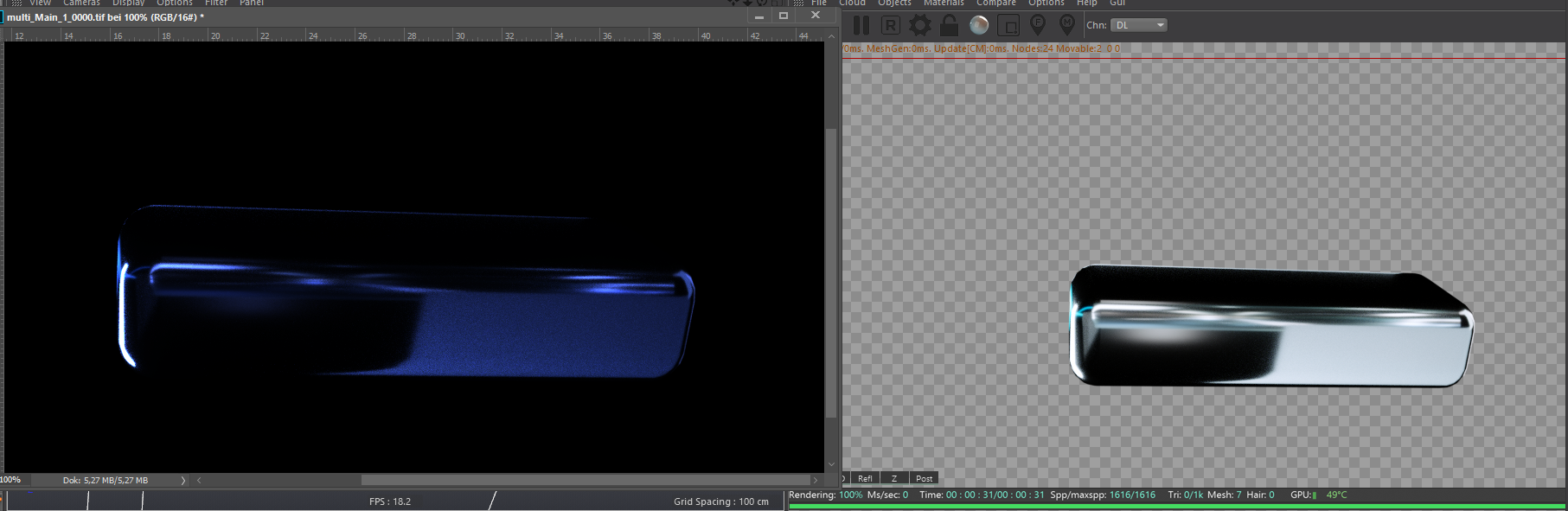

Hey I know this might be very simple, but I did before posting this post almost 5 test render with different settings but nothing worked. When I render with multipass enabled i get very dark results in the render passes when I import it in after effects or photoshop. I attached a demo scene file below with a cube. It might be very simple to fix it but because i'm new to the octane render i don't know why the render pass looks so dark and different from the color scheme.
Hope you can help me please need this fixed for an important client project very soon. In the Live Viewer the scene looks perfect but the multipass render result is different than what i see in LV.

Please read some manual and see some video tutorial for passes. It's normal when you use "tonemap type=Linear".

Thanks I saw now a few videos about it and wanted to ask you also what would you recommend rendering with tonmap linier and then adjusting the gamma to let's say 2.2 in compositing to get the same result like in LV for the render passes or rendering it with tonemap type Tonemapped or any other option ?
I want to get almost the same color like seeing in LV and tested now both and both options worked just fine but I want to hear what option you would recommend please.
