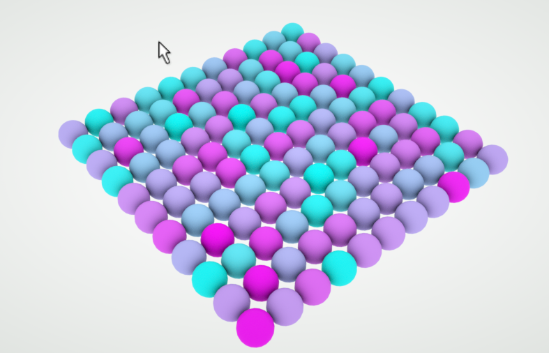

The randomColor node is one of the most important Octane node and works out-of-the box with maya instancers (particles or Mash)
currently it doesn't work with regular Maya Instance because of a very old bug in the plugin,
but it can work with regular meshes (no instance) :)
Basicaly you only have to change the Bake ID to 1 and set a different RandomSeed for each mesh, then randomColor node will work :)
(setting Bake ID to 1 is to workaround another bug in the plugin, it's a way to force the plugin to export the RandomSeed value)
Here is an example scene, the spheres are different objects (no instance) using the same material :)
RandomColorNodeForNonInstance.zip
(62.31 KiB) Downloaded 525 times
