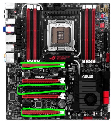

It look like a pci slot on my Asus Rampage IV extreme motherboard is not working anymore.
I changed cards to make sure it was not the card.
It is the middle slot (it used to work btw).. but when I have changed cards lately it seems to have changed something.
Maybe I physically damaged something or maybe something else might be the problem?
Do you guys have any idea what can be going on or how I can check to see what is going on?

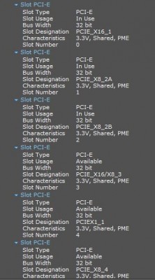

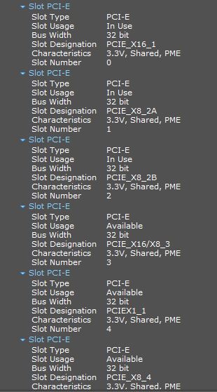

OK, I have noticed something very strange
See below.. there are three slot with 'slot usage' status 'in use', but Slot number 1 is physically no being used by me!?

When sticking only one GPu in the mobo on slot 1... still slot 1 and 2 are with status 'in use'
and the monitor is working but the card is not recognized as Titan Black. (it was when stuck in slot 0)
i'll now try and stick in in slot2 and see what happens.
Nice monologue I am having here :lol: Maybe I will be solving this by writing to myself :D
Edited/added1:
Stick in in slot2 gives smae result; 'no supported hardware detected'but monitor works and slot 1 and 2 are with status 'in use'
so it seems to be a problem in combination of slot 1 and 2.
For now do not have any idea how to proceed.
