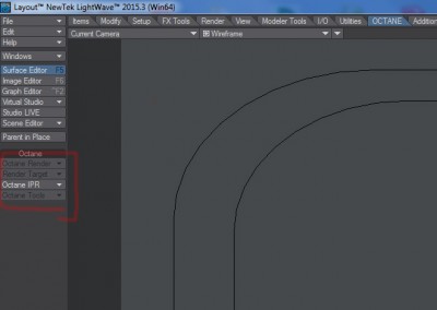

Hello Juanjo
I have a problem with lightwave.
When I restart the program I get a message telling me that it does not find the "master octane plugin" gives me the option to select the plugin, I select the file, but when the octane tab appears, all but the octane IPR (and In this tab only gives me the option of "export scene"
I have reinstalled the plugin and also lightwave but it remains the same.
What is the error?
I previously had a modeler crash due to excess polygons.
Thank you
juanjgon
Posts: 8867
Location: Spain
This problem sounds to me like a problem with the LightWave config files. Have you tried to delete all the config files to start LW in the default state? Later probably you could need to add the Octane plugin again, and once added, load the Octane menu branch.
Thanks,
-Juanjo
jcastillo
Posts: 23
Joined: Wed Jun 11, 2014 3:38 pm
If this was it !!
Solved.
Thanks again
