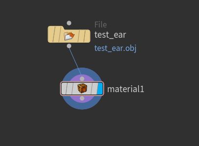

Hello,
I've been struggling with trying to import some obj models into Houdini. I can't seem to add an octane shader to them and the remain pink or don't even show up in the IPR window.
Can anyone share their workflow or explain how they handle obj import (using octane plugin)?
Thanks in advance.
juanjgon
Posts: 8867
Location: Spain
To set the materials to objects from .obj files, you must use the Material SOP node. The information is stored in groups, and the only way to set the materials to these groups is using the Material SOP.
Thanks,
-Juanjo
GraemeH
Posts: 158
Joined: Fri Jan 03, 2014 8:22 pm
Location: Ontario, Canada
Got it. Working now. Thank so much.
