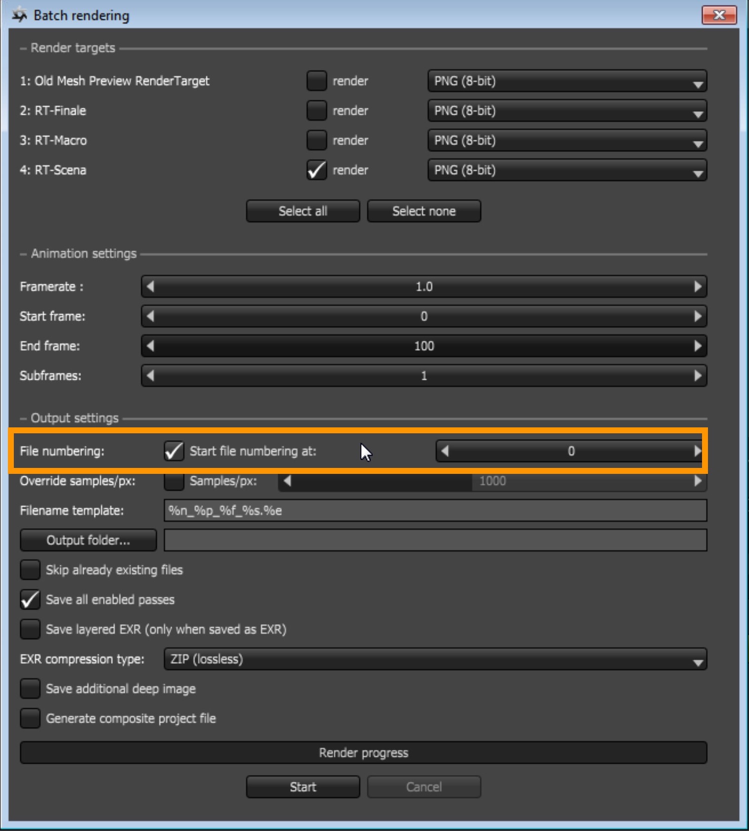

About the second issue with AE, probably the sequences are not matching becouse they start at frame 0 or at frame 1. Have you tried to slide the pctane sequence by 1?
In the Batch rendering window, in an animation is loaded, you have the option to change the starting frame numbering: ciao beppe
