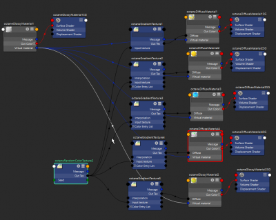

yes, you can assign random color texture using the virtual material. This is just a workaround and we are investigating to improve the workflow something similar with other Octane plugins.

BK wrote: you can assign random color texture using the virtual material. This is just a workaround and we are investigating to improve the workflow something similar with other Octane plugins.
Hey Bikram, this is not how the Random Color node works, have a look here ;) : viewtopic.php?f=126&t=60744
I can't understand what you wanted to achieve with your shading graph example,
it doesn't make sens, "virtual Material" can't help for this.
Also the "virtual Material" feature is buggy as hell and so badly implemented that it's useless.

Like I said earlier, this is just a workaround until we figure out something. The random colour is definitely not a simple fix for Octane render for Maya, however, we have come up with a possible solution now and we will look into it as soon as possible.
Using Virtual material takes a little longer setting up than running script but the virtual material will work on any kind of objects, instanced/non-instanced. In my opinion, users have more controls and advantages using it. So, we do not think it's necessary to remove this feature at this moment. We will keep on posting the updates on the forum for everyone. Cheers

Bikram, with your "workaround", you need to create as much different materials and gradients as the numbers of meshes to achieve what is asked by @p3taoctane.
So what's the point ? :shock:

:shock: Bikram, this is not what your example scene is doing:
Virtual Material doesn't randomize color that's not true, Virtual Material only assign randomly a list of predefined Materials.
Look at your scene, you only have 4 color variations at the same time, and to do that you had to setup 6 Materials using 6 different gradient nodes.
The supposed color randomization is only coming from you setting up by hand 6 different gradient node !!
This has nothing to do with color randomization.
If you have 1000 objects and want to have 1 different color for each object, with your workflow, users need to setup 1000 materials using 1000 different gradients by hand :?
this is not a workaround, this is completely useless...
