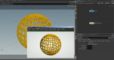

I can't render wireframe (Wireframe geometry node) in octane. Is there a way or is it not supported?
juanjgon
Posts: 8867
Location: Spain
You need to tessellate the object adding the Octane spare parameters and enabling the "Render as tessellated object" option.

Well, this is a Houdini modeling operation, so you need to make something like this in the Modeler. Not use if it is going to be easy.
