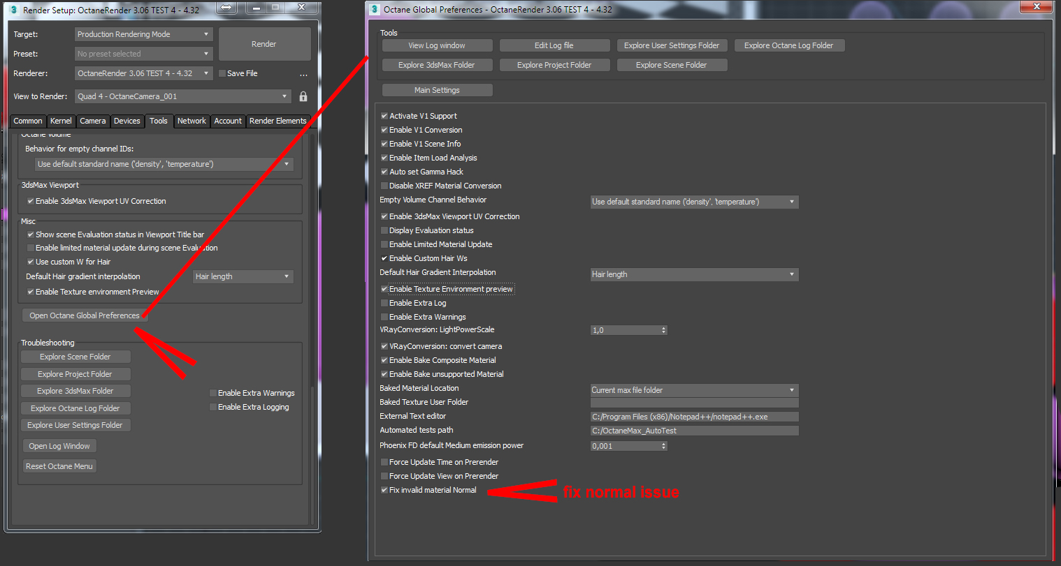

Changes of the 4.32 version, from 4.31
  • Updated Octane Renderer to 3.06 TEST 4
  • Updated Phoenix FD 3 support: added support of Liquid and Fire/smoke simulators with new modifiers.
  • Added load time fix of material normal set as value (to enable in Global preferences: 'Fix invalid material normal' )

Hi guys,
Fixing normal issue and Octane Global Preference

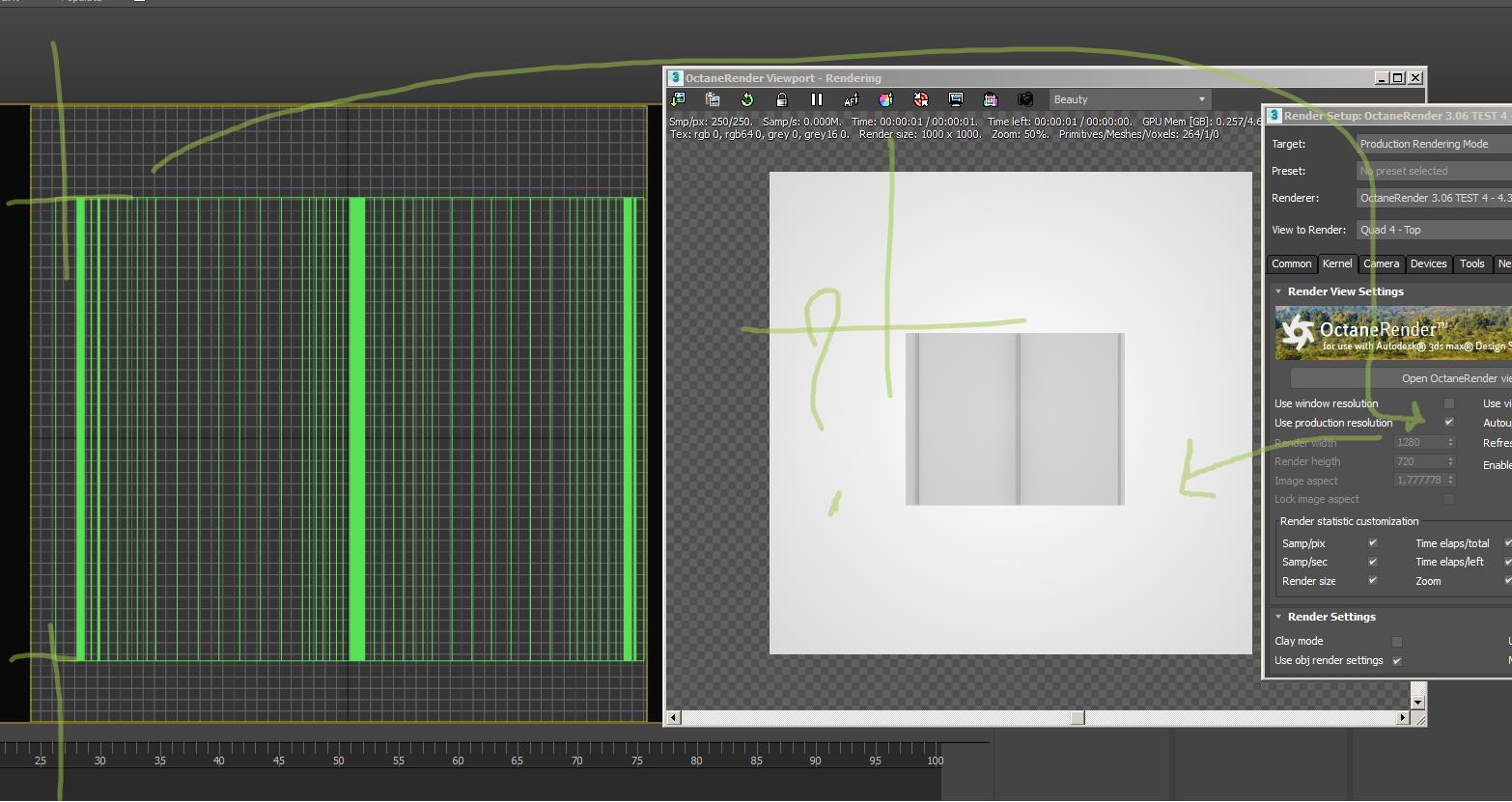

bug top vieport
camera + perspective - OK !
