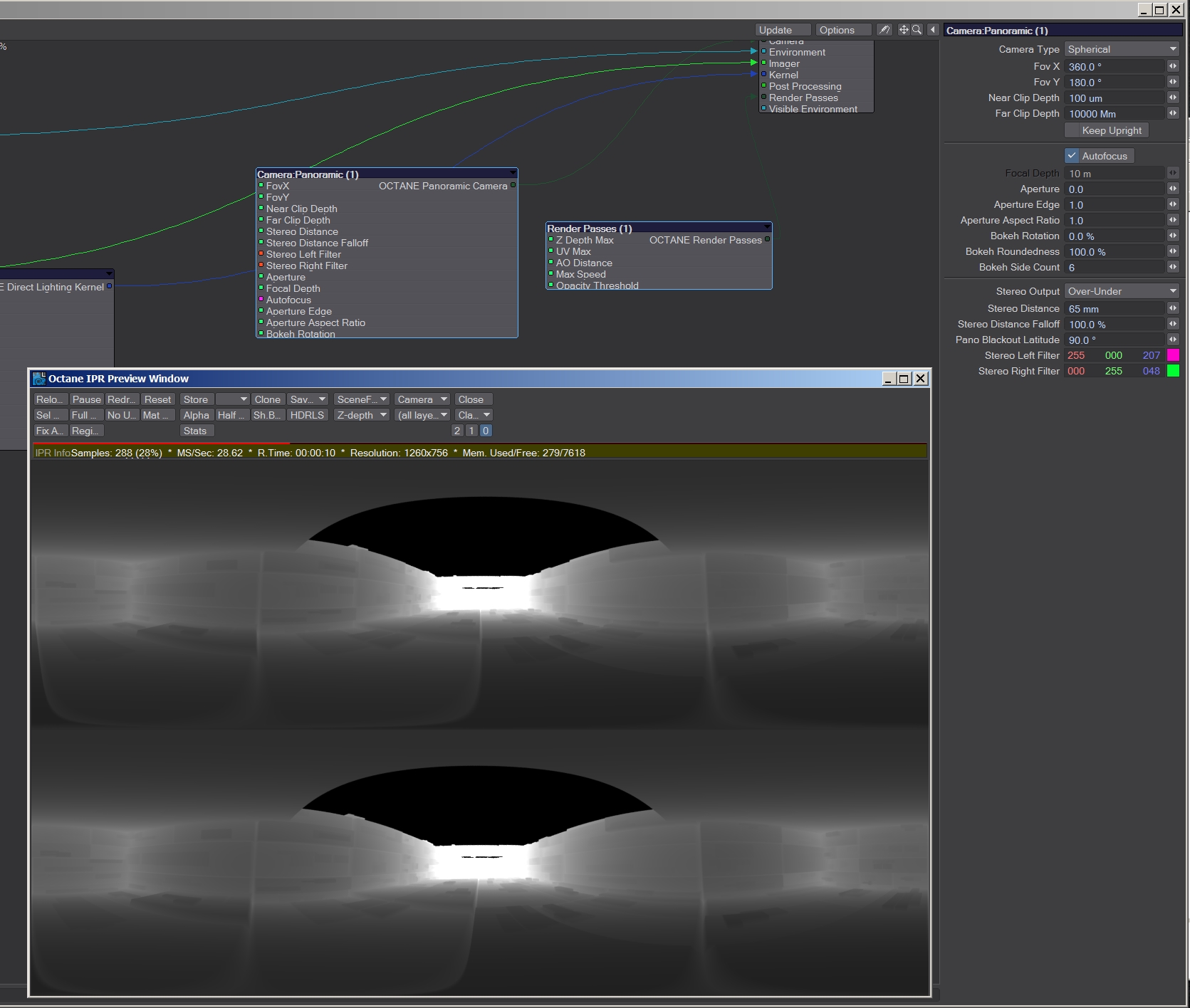

I am working on a VR project that shows underwater life. I need to get out a Zdepth pass to have the scenery and aquatic life fade into underwater haze in the distance.
I am using a panoramic camera with spherical projection. FOV are 360 and 180. Render size is 3840*2160 with over-under stereoscopic output.
Problem is that the zdepth pass is not working. 2/3 image on the left and right edges are completely black and only in the center part of the image there is the zdepth info. I will add an image about this.
Am I doing something wrong or is the xdepth pass just not working with panoramic camera?

http://imgur.com/WO1F1Oy - screengrab of the problem.
Panoramic camera Zdepth pass

I'm testing this feature here trying to use your same setup and it seems to work fine. What version of the plugin are you using? I think that you are not working with the latest 3.06 build.
In any case, if you want to send me a sample scene to reproduce your problem here, I could take a look at it.
