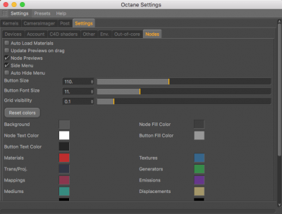

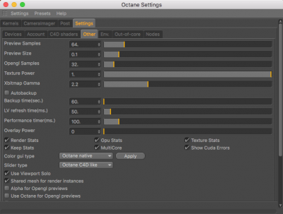

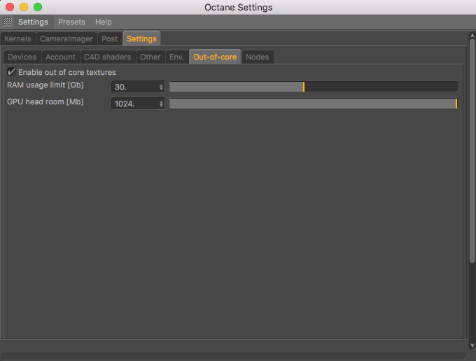

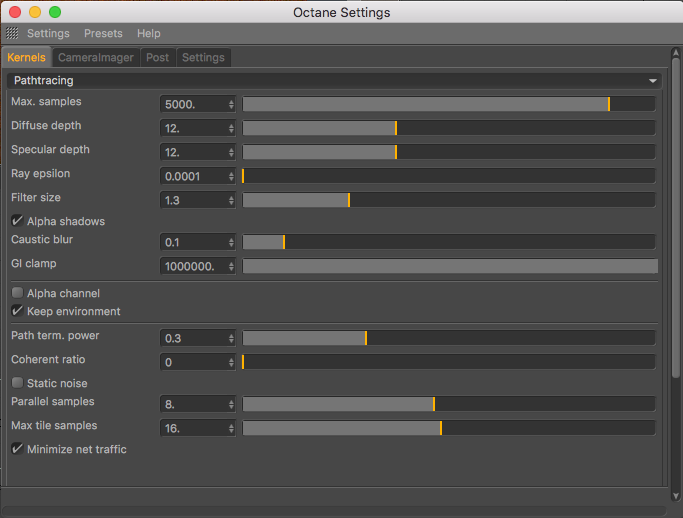

Here is a bunch of setting screen grabs and a log file
D
