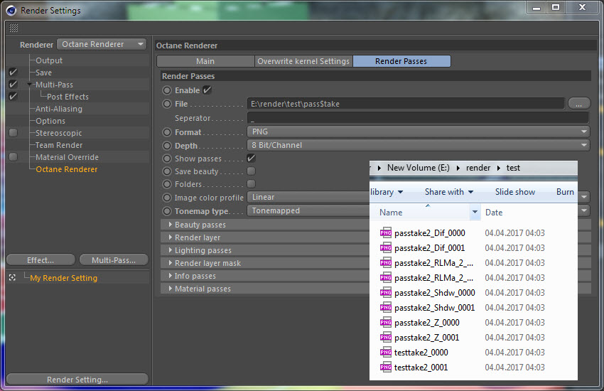

Hi aoktar, thank you for being there. I have a simple scene and i'm using the take system (but finally i'm not sure this is what we talk about) with 2 different views. I try to obtain 2 different files for beauty and 2 different files for MP but the second MP always replace the first one because of a unique name. Is it possible to have automatically different names for MP files?

PS : Ok i found the way to do that by using the C4D MP saving tab. But is there another way?

You can use like in image and video. But don't use c4d's save section for passes. That's why don't: viewtopic.php?f=30&t=60477

Thxs for your help. It works. I thought i had tried like that but should have made a mistake. And also thxs for the second TIP.
