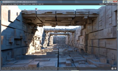

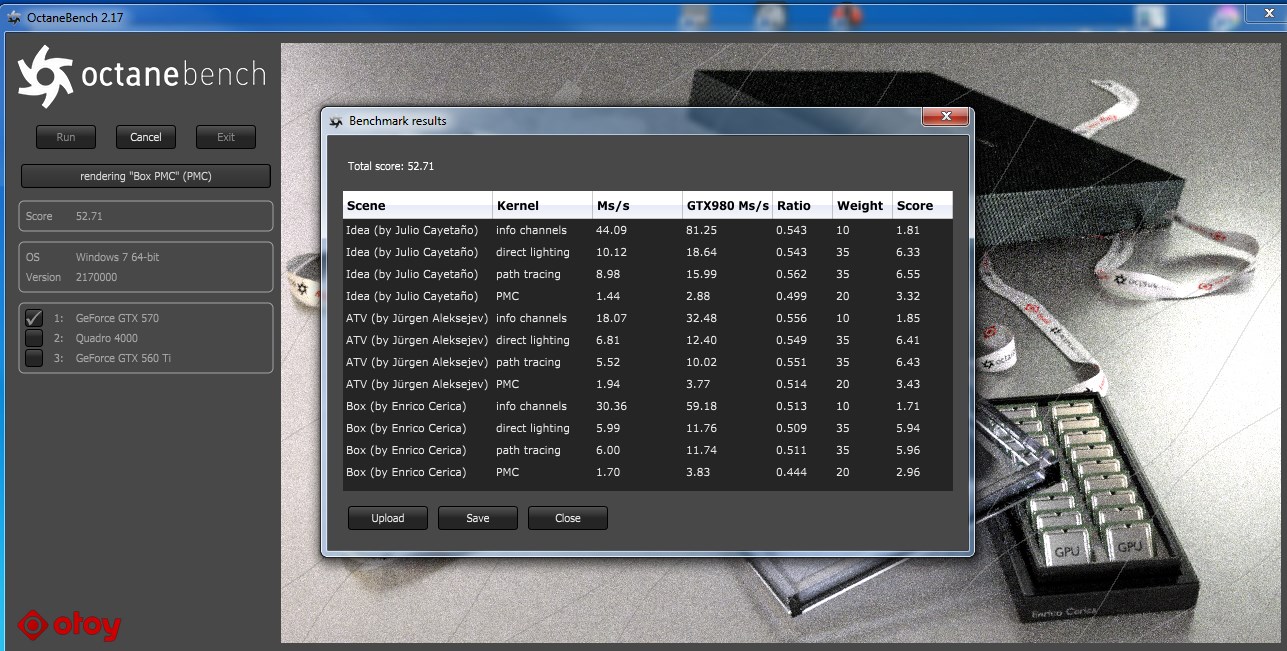

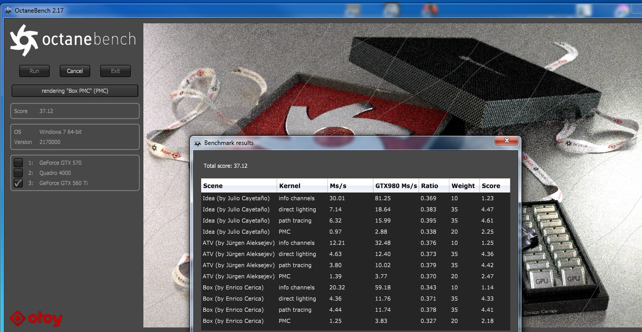

I have two GT video cards to work in the Octane. In Benchwell tests, one is faster than the other in ~1.3 times. But in tests in LW + Octane - one shows a speed 5-10 times higher than the other.
I absolutely do not understand what's the matter.

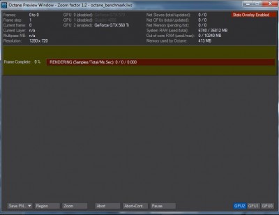

With tonemap 'off'- GTX 560Ti simple doing nothing. With tonemap 'on' - it's speed anout 0.7. But the same GTX 560Ti in standalone version of Octane shows 5.xx ms/s

You can't disable the tone map if you are rendering with only one GPU. At least one enabled GPU must have this option also enabled.
You need to enable any of the other internal GPUs with the tonemap option also enabled and disable the tonemap in the external GPU. Can you please make this test to see what happens? ... make it using the plugin and the same version of the Standalone, to see if you get the same performance.
