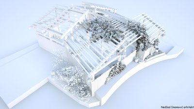

i had a similiar problem and it was with blender 2.56
I was doing some updates on a model and when i updated obj in octane everything went white, so i had to assign all materials again.
Its not happaning all the time, but only sometimes. I was adding ivy in my model.
i will try to reproduce problem again and post it here. Here is pic of my model

Yeah, i tried it again and then it was working.
But maybe it was because I might have saved the scene as Rhino 4 instead of 5.
This might cause changes in the material definitions but I am not 100% sure if I did this because this happened in a long and tough night.
When I experience the same again, I try to track / screenshot / explain it in detail and provide a sample scene.
