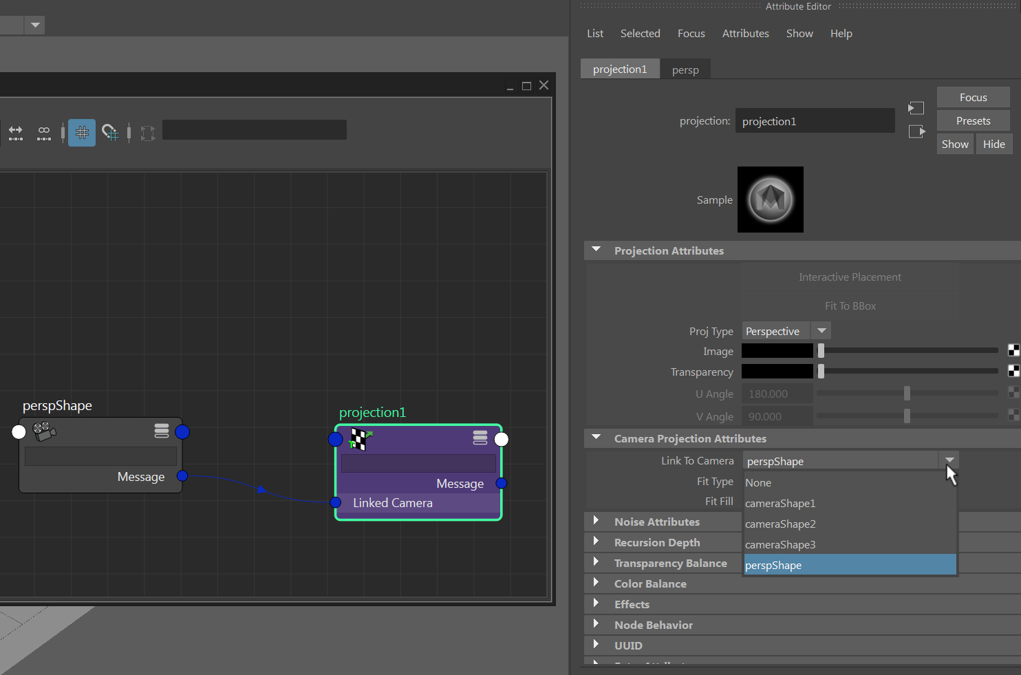

- For the Mapped camera string, the dynamic attribute of the Maya projection node should have been reused, copied from its AEtemplate.
it comes with callbacks automatically connecting the message attribute of the choosen camera:

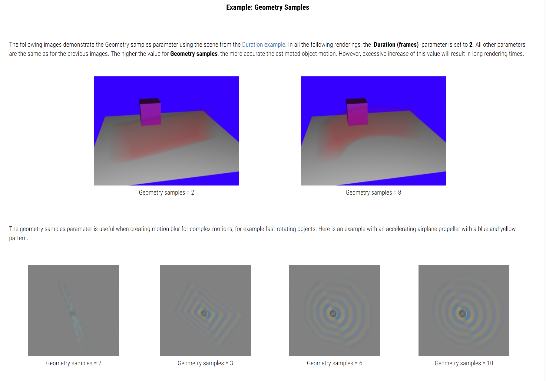

@Jimstar,
I expect to have these global settings for Internal MB (default values):
Shutter alignement = After
Time shutter (% of frame) = 20
Time Samples = 2
Subframe start (min %) = 0
Subframe end (max %) = 100
All this settings except one are the exact same settings as in Standalone so please report to standalone for limit values and details. (time shutter default 20 % is weird, but better to always respect Standalone default when possible)
Time Samples = Number of times the geometry is sampled for one frame
(So this setting is not expressed in time or in frame divider, it is expressed in samples, default and minimum value is 2 samples, max 100 )
a per mesh attribute is also needed to override the global Time Samples setting.
(Because Octane MB supports custom subframe number per mesh.)
Override Time Samples = 0 (default value)
Value 0 : no override for this mesh
Value 1 : disable motion blur for this mesh
Values 2 to 100 : override for the mesh the global Time Samples value.
This picture explain the Time Samples setting, called here "Geometry Samples".
