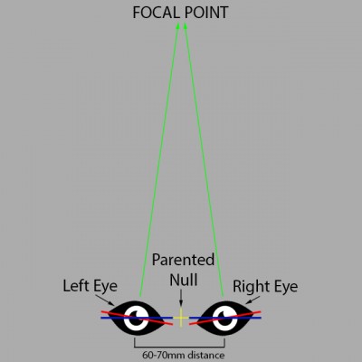

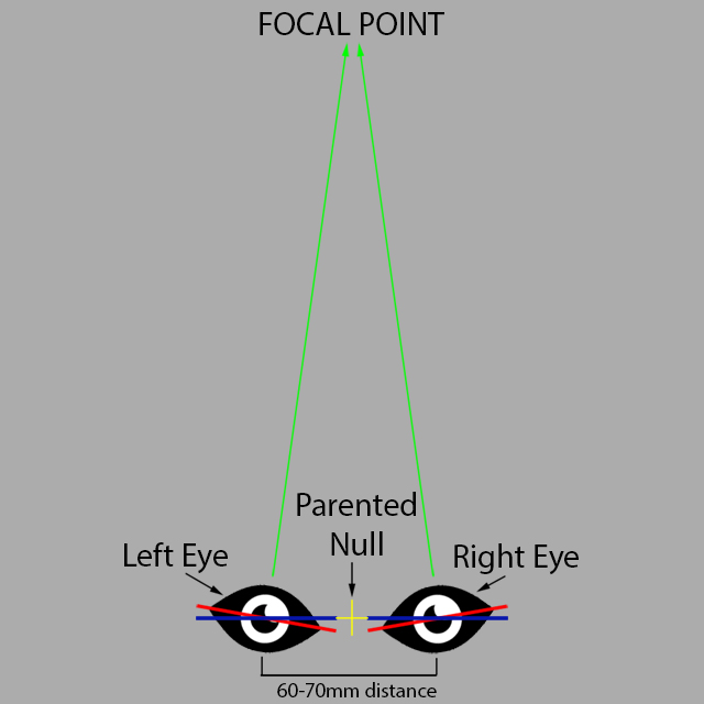

For the camera setup it looks like a left eye camera and a right eye camera parented to a null with some standard separation between them? and a front facing focal point?
This focal point causes each camera to be slightly a few degrees off from 'perfectly facing forward'?
My question is does each eye(camera) stay in the exact same spot and then look in all 6 directions?

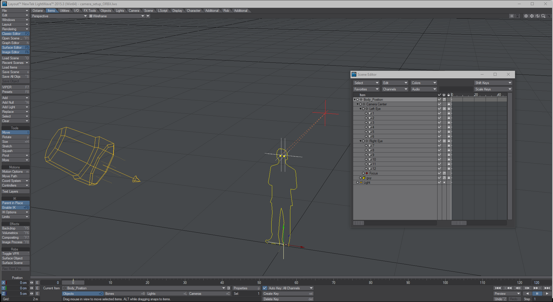

Me Again!! I figured it out and I've created a default scene for people.
How to use in your scene:
1. Select 'Load Items from Scene...' and find 'camera_setup_ORBX.lws'
2. Load all Objects and 12 cameras
3. Select object(null) Body_position and place it where you want. The Null is meant to rest on the ground.
4. Open Scene Editor and select the Camera called Left Eye > 1
6. Switch to Camera Left Eye > 2
8. Repeat until you have 12 images.
9. In Photoshop create a new document 18432px X 1536px
10. Place images from left to right 01,02,03,04,05 etc
11. This is the strange part.. you have to flip every image horizontally (left to right) or else the whole scene appears backwards when viewed.
11. Export image as PNG.
Notes
- I've set it up so the eye height is 66 inches from the ground. If you want to adjust this you can adjust the Camera Centre Null object. Only move in the Y axis. This is disabled by default (as are most tools for the object)
- You can select the object(Null) Focus to adjust where the eyes are focusing (it only moves in the z axis. I'd try to keep it over 2 meters away
- The Guy.lwo is set to be invisible when rendering in octane.
- The model is set to be 5' 10" tall
- The Lightwave Cameras are all set to have a horizonal and vertical Field of View of 90.00 Degrees which the octane camera uses.
- Adjust the Body_Position Object (Null) if you want to rescale. This is set off by default.

I don't have LW so I'm not too sure of how it interacts with Octane but but if you are trying to create an omnidirectional stereo image using 12 individual perspective cameras looking around (or using two panoramic cameras) it's not going to work. Omni-stereo is more complicated.
In your current setup when you are looking sideways in VR you won't have any stereo effect as the cameras will be aligned and share their optical axis. When looking in the back, the eyes will be inverted. There is a dedicated algorithm in Octane to provide panoramic stereo, the camera has to adjust the direction at the ray level to smoothly rotate around while keeping the correct interpupillary distance.
