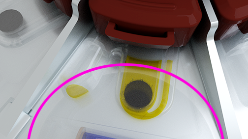

I have on all my renders with reflection a rond circle (shadow) on the bottom half of my renders.
How can I remove this?

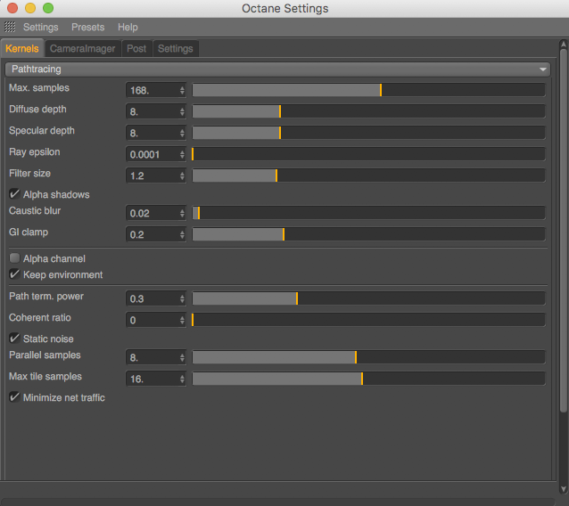

Hi Cre8ing,
are you using the DL AO kernel?
Could you post a screenshot of the kernel settings?
ciao beppe
Cre8ing
Posts: 5
Joined: Sat Feb 25, 2017 12:30 pm
Hi Beppe
This circle appears only on Specular Materials.
It is visible In renders with direct lightning and Pathtracing
I changed the Index and it is gone now.
