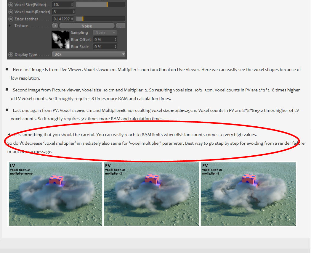

It's out of memory. Don't forget to read this page: https://docs.otoy.com/#cinema-4d-v3-plu ... -generator

If you read page you should see that's memory dependant object.

I'm not sure that you read completely and see voxels will spend RAM. I have 32gb ram and out-of-memory with your object. Being a super simple box that's not guarantee to spend small memory.
For Editor: 5400/5 * 2700/5 * 14925/5 -> 1080*540*2985 = 1740852000 voxels. it's 1.7Giga voxel count and propably much

Bigger voxel values
