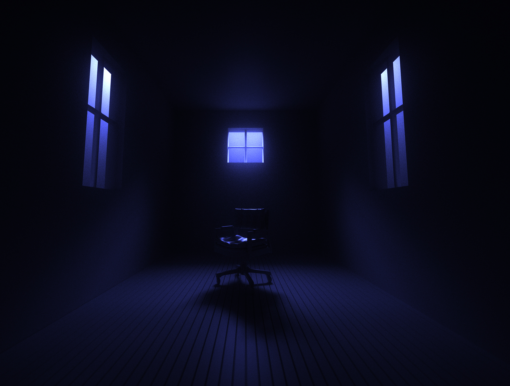

Ok Paul I get that we can create a Foggy scene using a médium with scattering and I understood how it Works, but, no matter how I tweak the values Im not abel to get volumetric lights ("God rays") showing, neither with a sun light nor with an area light entering by a window. It would be very nice if you set up a little scene (a box with a hole) and try to get it working and post it for us to study. I have been browsing all the net and I find lots of exemples for C4D but none for Modo, I tried also the technique using a "fog cube" you can see it here https://youtu.be/LSIV6HVYdj8 but I'm not able to replicate thata perfect volumetric light inside Modo.
This is what I get no matter what

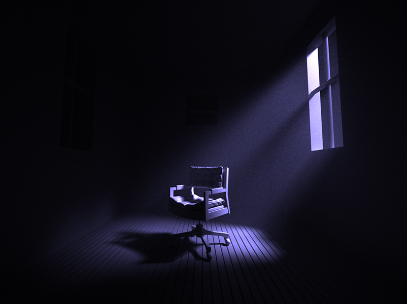

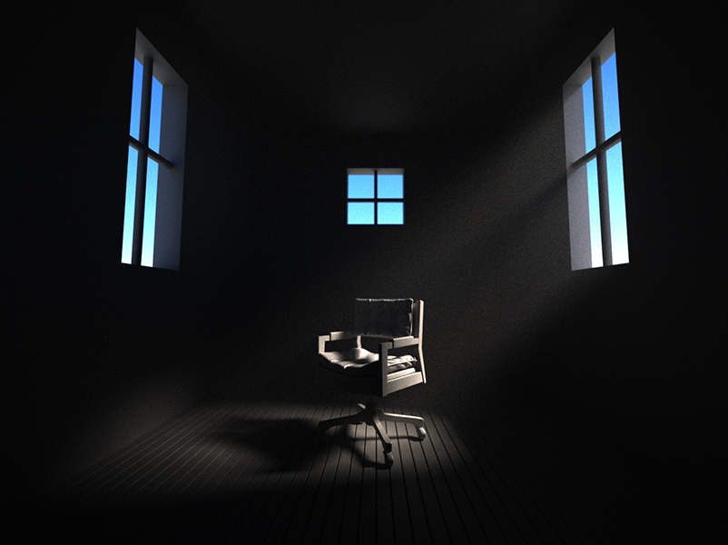

Niklas, thank you very very much for your files, finally I understood what was happening, I was using and area light, and they doesn´t create volumetric light.
Point lights and directional lights (Converted in sun on the environment) do.
Here 2 tests for the same file using both options and showing the volumetric lights
Thank you again, have been very helpful :)
Directional light
Directional light
Point light
Point light
