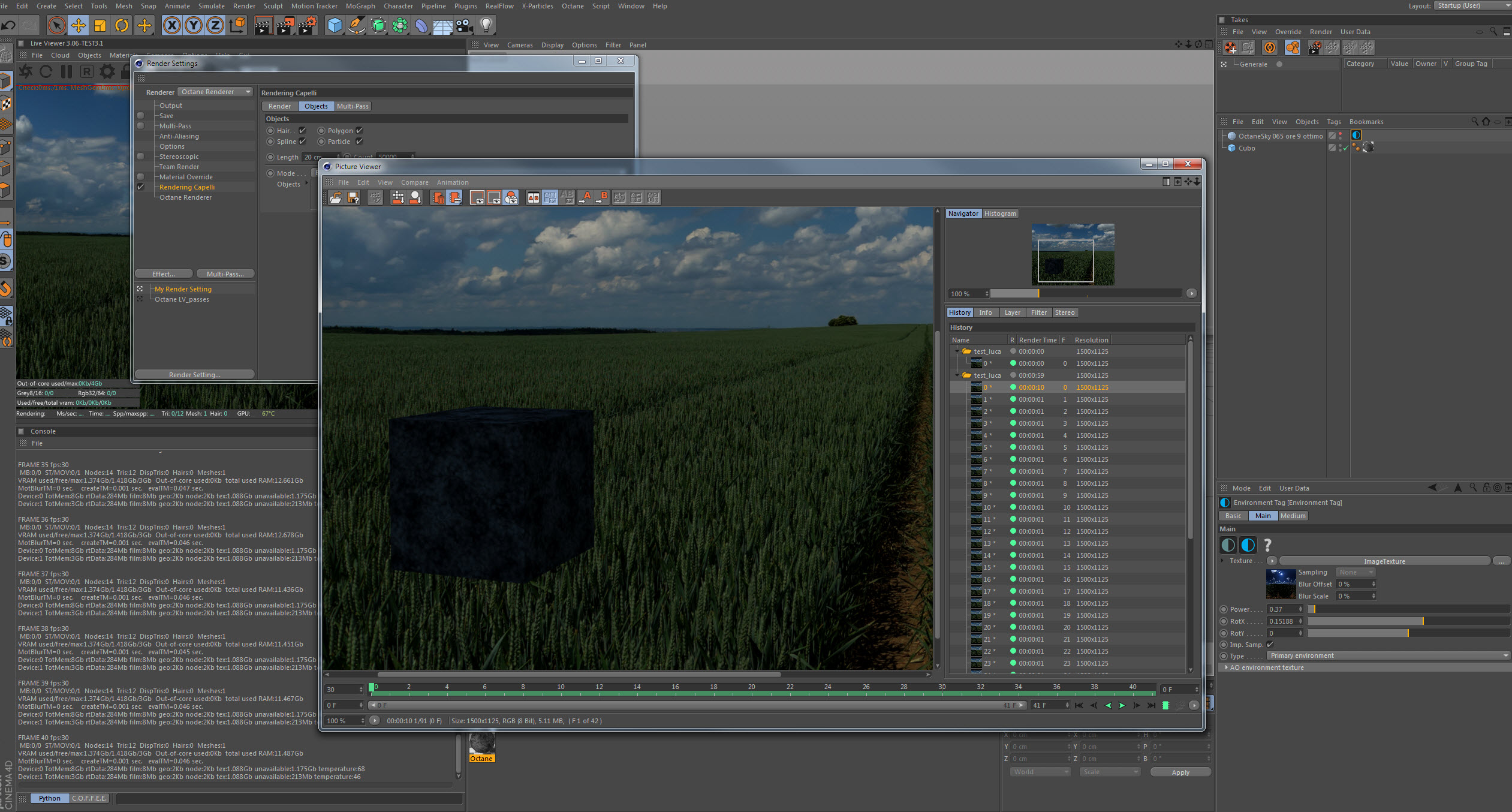

15K hdri on sky and 8k png on box. See render times. Next frames are just 1sec as should be.
We don't resend any images in scene between frames. So will not spend any extra time to reload these. Also moving an object will not cause reloading images in materials. I'm still supposing you have a different problem.

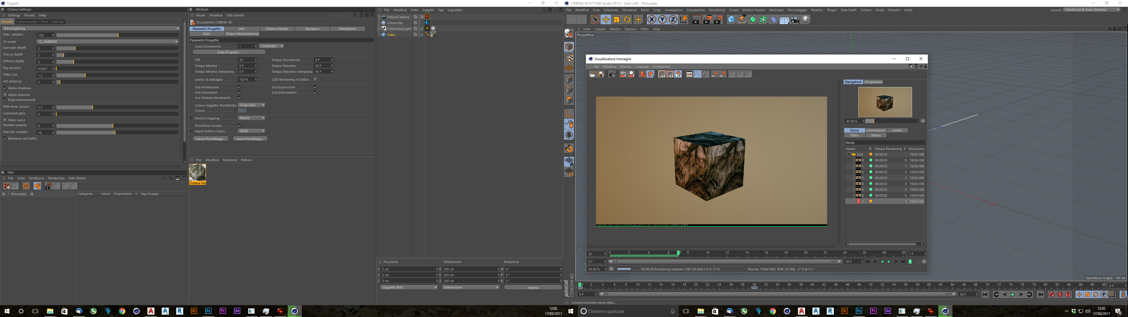

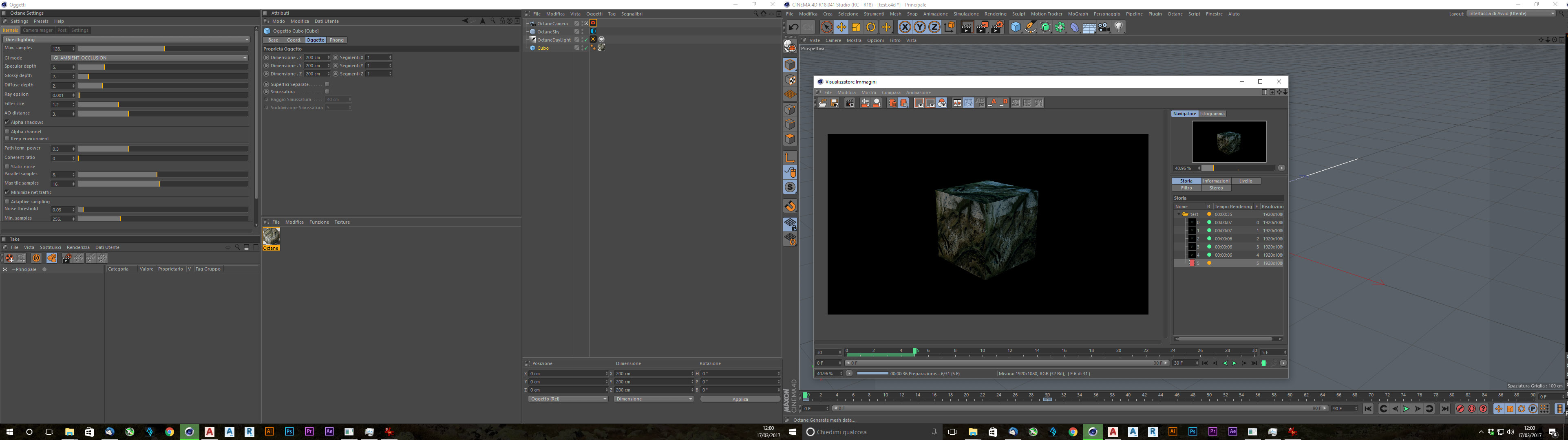

But today we made another test: we've create a new scene, very simple, with an high texture in it (a png 15000x12000), created with octane 3.06 with very few elements. We've saved the scene and try to render it with Octane 3.06 and Octane 3.03.3.
We had the follow result:
This with Octane 3.03
Render time per frame after the first one, 2 seconds
This with Octane 3.06
Render time per frame after the first one, 6 seconds
The rendered images are different due to Sun configuration. Then we made the exactly same render image (different sun settings between 3.06 and 3.03) but we had same render time results.
3.06 have more than double render time per frame due to "preparation Time".
